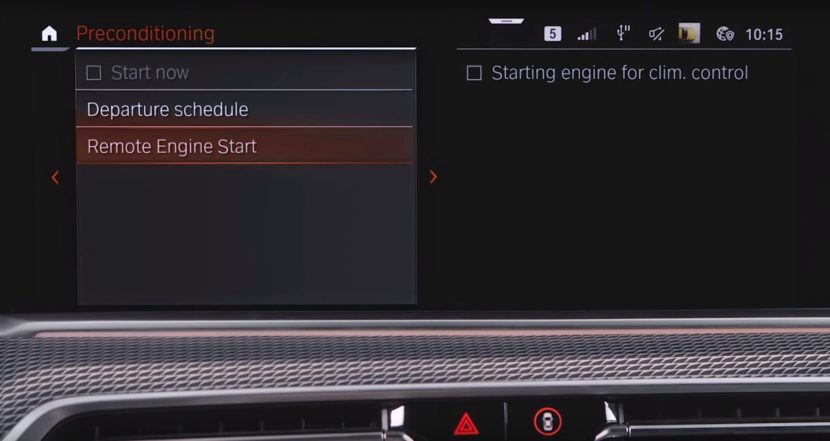

    Before doing anything you need to activate the function from the car’s iDrive system sub-menu. Go to Car – Settings – Climate Comfort and then select Preconditioning/ventilation from the sub-menu. The Remote engine start option will pop up and you’ll have to activate it. After that, there are three ways to start you car’s engine to heat up the cabin: through the BMW ConnectedDrive app, with the key fob or the BMW Display key.
    The app allows you to start the car’s engine from the longest range just by pressing a couple of buttons. Using the BMW key fob you can activate the heating by pressing the lock button three times while with the Display Key, you have a sub-menu dubbed preconditioning, which allows you to start the engine remotely. The engine will automatically shut itself off after 15 minutes or, if you get in the car before that, you can do it manually. If you’re using a traditional key fob, you can turn the engine off by pressing the lock button once again three times quickly. Hope this helps you get through winter easier!
