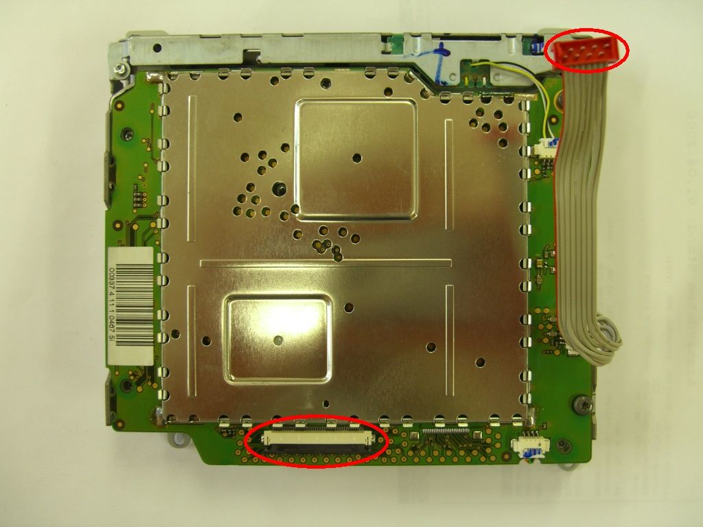

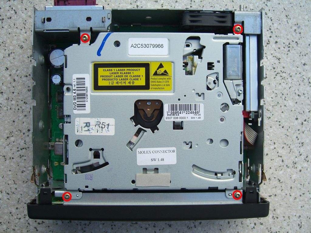

    To open the MK4 you cut he seal at the back and remove the top cover carefully.
    It should look like here:
    The drive is screwed with 4 Torx screws (red circles). Unscrew them.
    The drive is connected with 2 cables. One of them simply is plugged in (red connector) and can be released by pulling. The second cable is a ribbon cable.To release it you first have to move the locking mechanism on both sides carefully with a small screwdriver towards the cable as shown here:
    After that the ribbon cable may be pulled out.

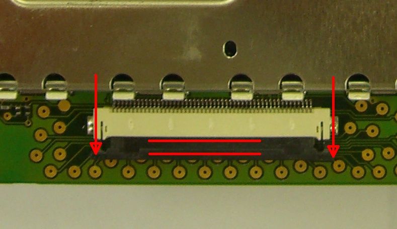

    We will have to open some other of these cables during our repair process. The way of doing it is always the same.
    The sat nat computer has lost its drive now.

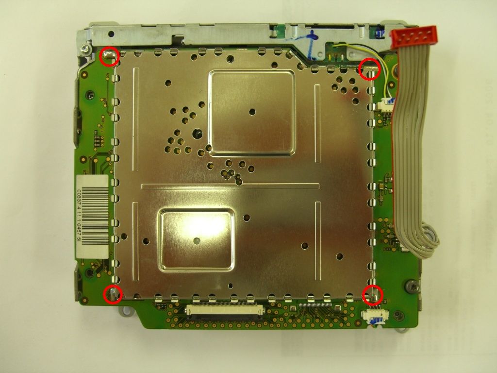

    On the top of the drive you see a shielding plate which is soldered at its four corners.
    Open the 4 solder points with the desoldering braid or a suction pump. After that you may remove the shielding plate carefully.
    Now it should look like here:
    The red circles show the former solder points of the shielding plate.

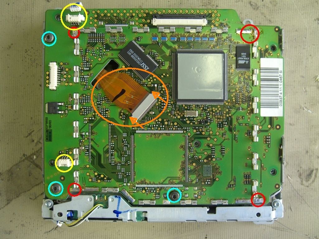

    Next you have to open the two connectors (yellow circles). After that remove the ribbon cable of the laser unit (orange circle) as described above.
    Now you have to unscrew the tree Torx screws (green circles). The printed circuit board (PCB) is just plugged in on its right side (on the photo).
    It should be flapped to the right side. Now it should look like here:
    Remove the two ribbon cables (red rectangles).

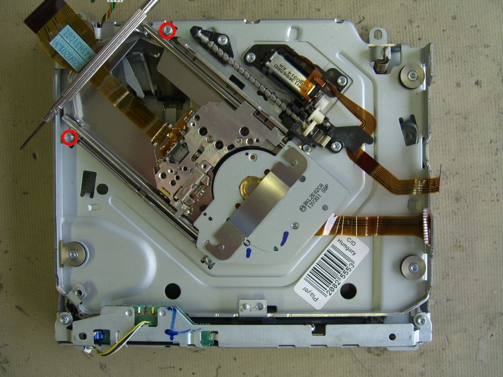

    On the laser unit you can see a small metal shield. ItΆs screwed with a small Torx screw and a very small crosshead screw (red circles). Remove both screws.
    The metal shield connects the laser unit with the spindle drive with shaft joint (green circle). In addition the metal shield actuates the end switch (yellow circle).

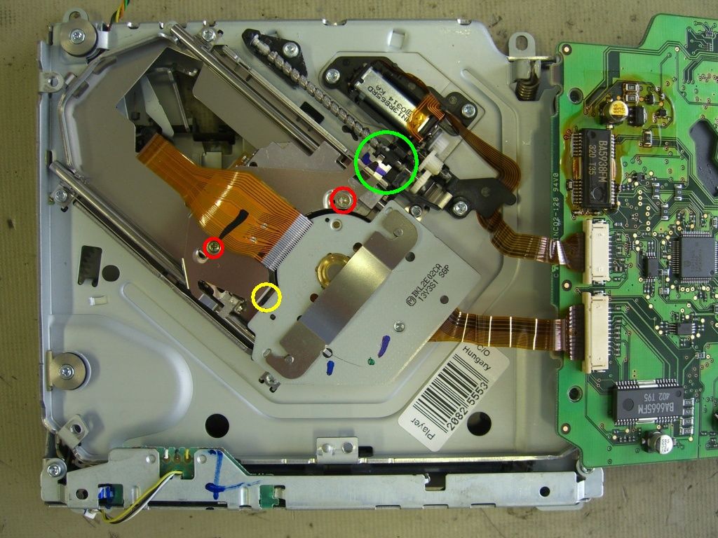

    Now you may move the laser unit on its rails. It should look like here:
    Next you have to remove the two T4 screws (red circles) that secures the rails at there far ends.
    The laser unit can be removed now by sliding it out carefully.

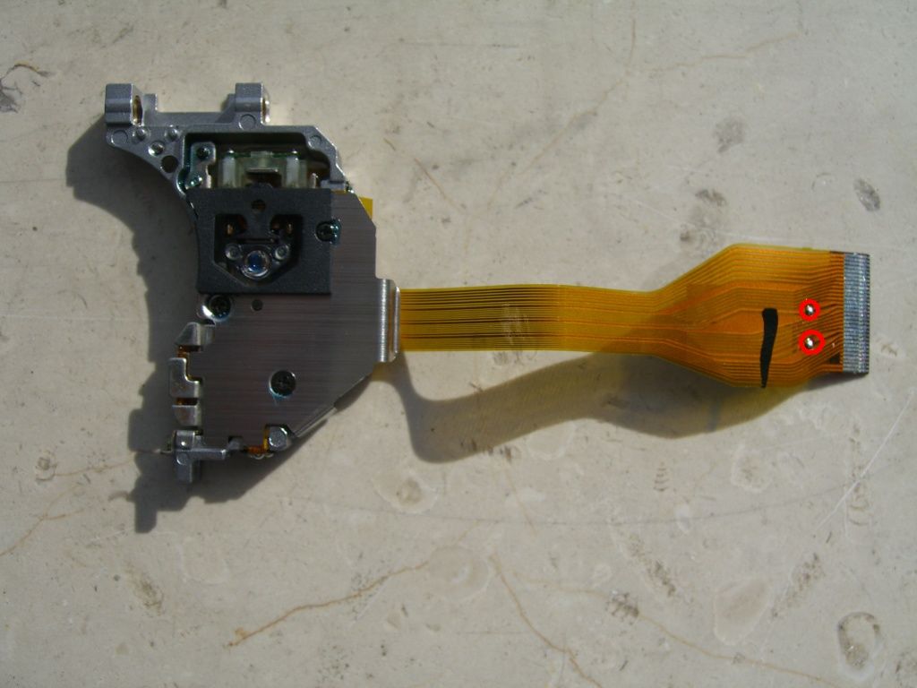

    Before assembling and soldering the shielding plate you have to remove the two small solder bridges on the ribbon cable (red circles). See here:

    The laser unit itself is called „SF-HD4“.
    You may buy it
    - at ebay (search for seller „spillomax“) about 40 euros plus postage and packing
    - as remaining stock at Pollin (were I ordered) for 4.95 euros plus postage and packing
