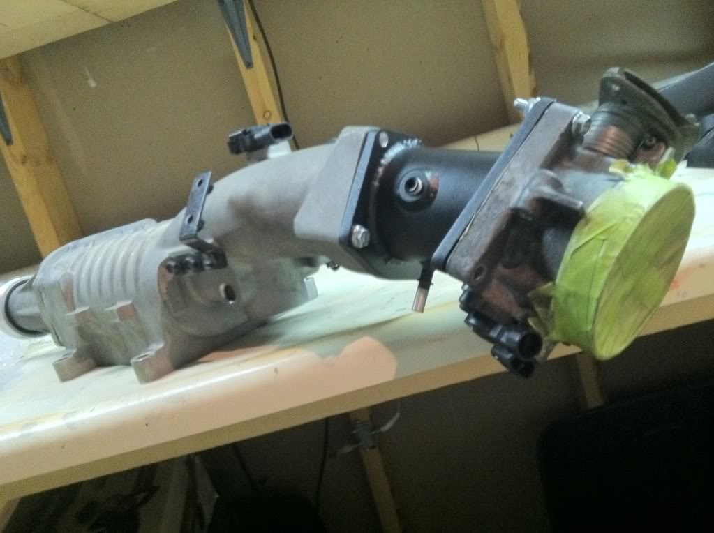

    To begin, for anyone unaware, the M62 (also referred to as the MP62), is a positive displacement (roots type) supercharger manufactured by Eaton for use on many applications. There are many variations of the M62, though only one will fit our application. This particular M62 was designed for use with the LSJ motor used in the 05-07 Cobalt SS/SC and 04-07 Saturn Ion Redline, as well as in a bolt on J-body kit released by GMPP.
    The GMPP kit has been discontinued, but lucky for us, we can pull pretty much everything needed from an LSJ car. This style M62 can actually be used on any Ecotec motor, as the castings and accessory locations are the same between the various Ecotec models (this pertains to US 4 cylinder Ecos, as there are overseas versions of the Ecotec that are quite different).
    The roots type supercharger is basically an air pump, which uses rotors to force a higher than normal volume of air into the manifold where it is pressurized then sent to the motorʼs combustion chambers. There is a wealth of knowledge to be found on the internet about how superchargers work, and you can start your search here.
    1. I found a great deal on a M62 from a Pontiac Bonneville, can I use that on my J-body Ecotec?
    No, you cannot. Each version of the M62 is intended to fit a specific manifold, made for a specific motor. You need to use the M62 designed for the Ecotec.
    Easy Solution: If you canʼt manage to find a complete kit, you can source your blower (and all other needed parts) from any LSJ equipped Cobalt or Redline.

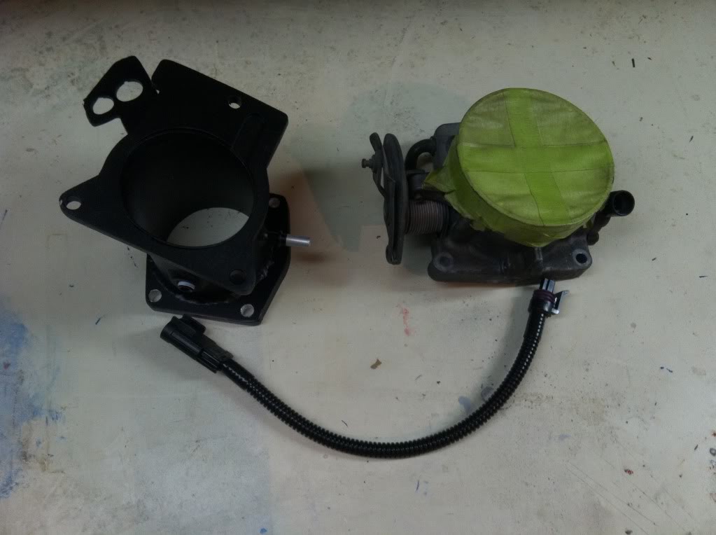

    Correct, the LSJ uses an electronically controlled throttle body, and we use a cable driven throttle body. Go ahead and sell that LSJ tb for some extra cash. You will either need to get an adapter for your stock throttle body, or use a different throttle body entirely (also requiring an adapter, and I will cover both later on). The GMPP kit included a throttle body adapter, which you can often find used adapters floating around for sale on various forums. MD Enforcer also offered adapters in a GP a while back, so those can be found on the forums as well. Your other option is Katech Performance, who is the original manufacturer of the adapters, and is once again making them.

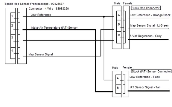

    6. T-MAP or MAP sensor? Whatʼs the difference? Which do I use?
    Either can work, and is mostly depending on how you are tuning. The T-MAP is a 2.5 bar sensor, and is a must if you are running the GM reflash. You can also use it when custom tuning, though it is not necessary. Our stock 1 bar MAP can be used with software like HP Tuners. Keep in mind, the T-MAP is a combined MAP and IAT sensor in one unit, so if you choose the route of keeping the stock MAP sensory, you will still need to find a place for your existing IAT.
    *TIP: I kept my stock MAP sensor, and ran a threaded IAT sensor instead of my stock. These are easily found on 4th gen F-bodies, as well as Quad 4 motors. This is plug and play with your existing IAT connector. I drilled and tapped the TMAP hole in the manifold to accommodate the threaded IAT, then branched my MAP into the vacuum lines used for the fuel pressure regulator and boost gauge.

    2. Throttle Body Adapter – Katech Performance #KAT-A3309-R02

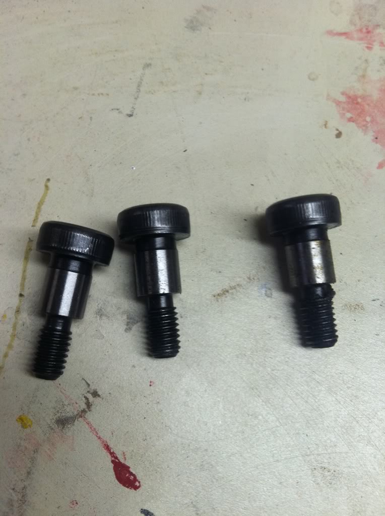

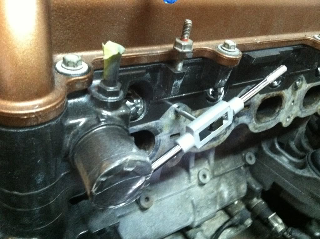

    Intake Manifold Bolts
    The intake manifold is designed for using M8 studs, while our L61 head is tapped for M6. This creates a problem reusing our stock M6 studs in the head, as it gives the manifold a little wiggle room from all of the vibration, and can eventually lead to something like a stud sheared off in the head. The GMPP kit came with M6-M8 conversion studs, though I donʼt think you can get this through GM anymore (and even if you could, I donʼt recommend it…theyʼre petty light duty and have poorly cut threads). Tinkles turned me onto the thought of shoulder bolts, and this is probably the best/most cost effective route.
    You can grab these from Fastenal, McMaster-Carr, and I think Lowes has select sizes. You will need 8mm diameter shoulder with M6 threads. If youʼre going to order from Fastenal, hereʼs your part numbers:
    (2x) 60mm long shoulder – Fastenal Part # 0154419
    - McMaster-Carr Part # 92981A215
    (5x) 10mm long shoulder – Fastenal Part # 0154418
    - McMaster-Carr Part # 92981A200
    To the best of my knowledge, GM does not sell the kit's conversion studs separately, they were only part of the original GMPP kits. I've checked the parts numbers through both GMPartsDirect and 3 local dealerships, none of which could find the part numbers in their systems. However, if you are really wanting to try and track a set down, the part numbers are:
    12590821 - short manifold stud (quantity needed: 5)
    12590822 - long manifold stud (quantity needed: 2)

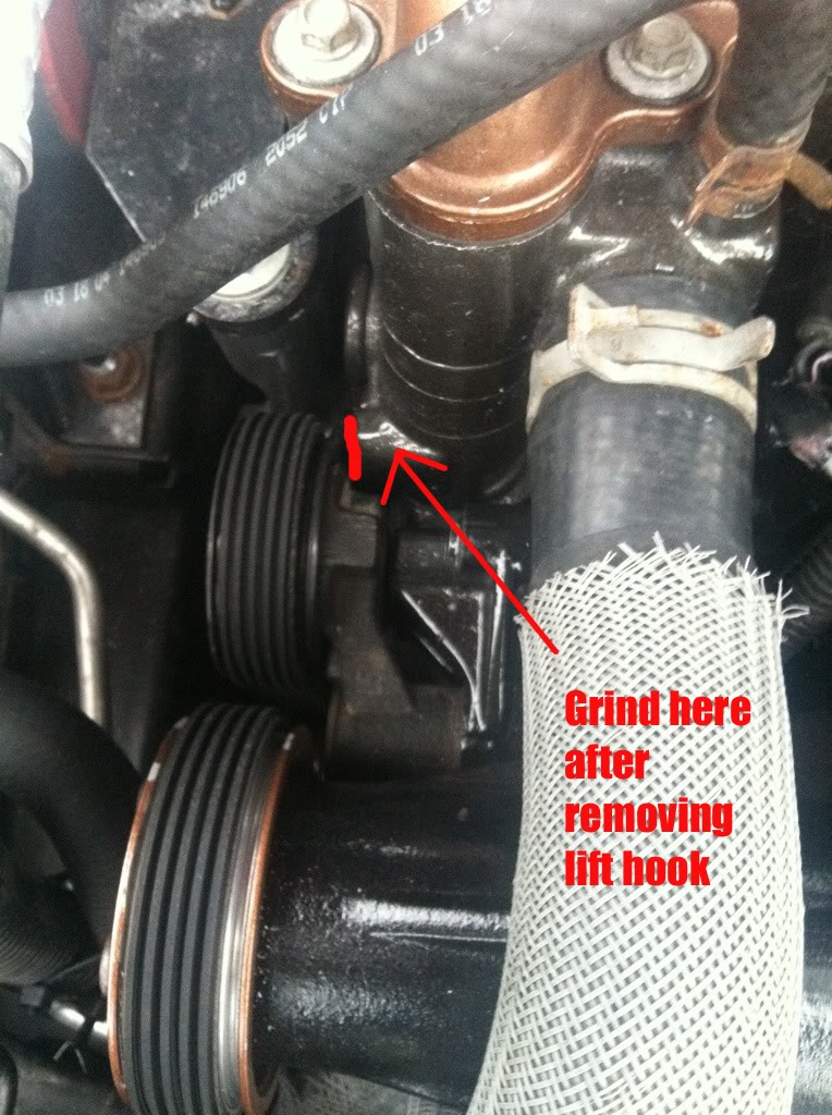

    1. Making room for the tensioner assembly – Youʼre going to remove the lift hook from the head (front passenger side of head), and youʼll need to grind down the surface it mounted to in order to make enough clearance for the tensioner assembly. If you have an air grinder, this should take seconds to do. A dremel can also grind this down with ease, and if you have no access to any kind of rotary or power tools, cast aluminum is soft enough to make filing by hand relatively easy. You donʼt need to remove much, I think I removed about 1/8” and I have plenty of room now.
    2. Cleaning up the head for new manifold
    Once you have all the old equipment off and itʼs time to install the new intake manifold, I would take a few minutes to clean up the mating surface on the head. I recommend cleaning the threads before installing new manifold bolts. Last thing you want is to snag and strip a thread in the head. A M6x1.0 die will work great, and if you donʼt have any, you can pick up cheap tap and die sets at Harbor Freight for $10. I would also take some intake/carb cleaner and scrub the side of the head good to make sure the gasket makes a good seal.

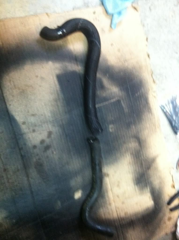

    3. Trimming lower surge tank hose
    The instructions tell you to cut about 1” off the end of the lower coolant hose on the surge tank, I would also recommend using a few zip ties and pulling the hose closer to the radiator to give a little more clearance from the supercharger belt.

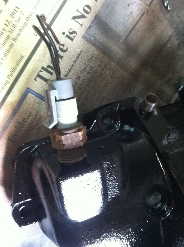

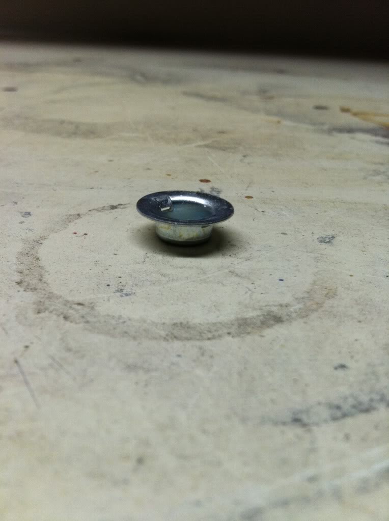

    4. Plugging the pressure sensor hole
    If you are buying a used blower from an LSJ car, itʼll probably have a pressure sensor mounted on top. We do not use this on a J-body. The hole needs to be sealed (otherwise youʼll have a massive vacuum leak), some people just leave the unused sensor attached, and some plug it. I chose to plug the hole to help clean things up cosmetically; you can grab tap in 3/8” axle nut plugs for about $1 from the hardware store.
    5. Wiring the T-MAP sensor – This obviously does not apply if you are utilizing your stock MAP and IAT sensors.

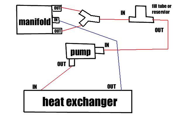

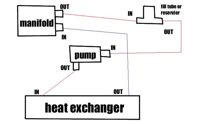

    2. Heat Exchanger – A popular choice for mild setups is the h/e from a Mustang Cobra S/C, you can easily find these for $50 and less. There is also a huge aftermarket when it comes to heat exchangers; ZZP, OTTP, Griffin, Fluidyne, and more. I recommend something with a dual pass core, as these will help lower overall temps, as well as aid in bringing your temps down quicker between consecutive pulls.
    3. Manifold Endplate – The stock endplate is designed to bring the coolant in the bottom, pass through each core one at a time, then exit through the top. This is somewhat inefficient as each time the coolant makes itʼs way from one core to the next, itʼs being heated exponentially, and losing itʼs ability to cool the air passing through the manifold. The dual pass endplate is a popular option, and is a great option especially when used in conjunction with a dual core h/e, such as a ZZP S3. Iʼll go more in depth on this in the “Upgrades” section.

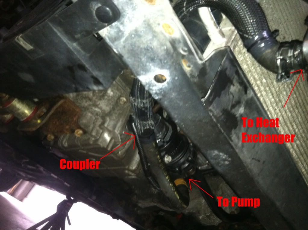

    4. Heater Hose – Youʼre going to needs some bulk Ύ” heater hose, couplers, and it will be helpful if you can grab some preformed 90* elbows. I recommend using 90* elbows right off the endplate, as there is not much room and bulk hose will kink.
    If youʼre using a heat exchanger that has the in/out on opposite ends (like the Cobra), I find itʼs hard to run bulk hose from the h/e between the radiator and support and to the pump without kinking it. If you grab the two heater hoses from any LD9 J-body, the are a prefect fit (they are a bit more “U” shaped on the ends than ours). Snip about 1” off the straight ends, then join with a coupler, so that the two make a sort of “S” shape. This wraps right around the radiator to the pump perfectly with no kinks or excess length.
    5. Filler neck or reservoir – I recommend scrapping the stock filler neck and using a reservior, the filler neck doesnʼt give much room for expansion and using a reservoir will overall allow a bit more fluid in the system. Try to make it the highest point in your system, this will help to keep air bled out. Air in the system not only diminishes cooling, but it is hard on the pump and will decrease itʼs lifespan.
    6. Coolant Mix – You can run a 50/50 mix, though I would recommend using mostly water if your climate permits it. Distilled water is much more efficient at transferring heat than antifreeze. I run distilled water with a little Water Wetter additive…these are claimed to help reduced temps, I donʼt know if it holds true, but they do have corrosion inhibitors like in anti freeze. I will of course be switching to 50/50 for the winter time.
    Plumbing when using a single pass endplate:

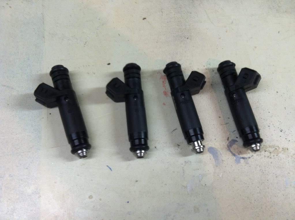

    Upgrading your fuel injectors is a must. There are many options between compatible factory injectors, as well as a large aftermarket. Injector size will be determined by your overall power goals. Youʼll also want to choose an injector that is large enough that you wont exceed 80% of itʼs maximum duty cycle, but at the same time you donʼt want a ridiculously large injector as it will be difficult tuning. For example, if you need 47lb injectors, running 80lbers will be overkill.
    RC Injectors has a handy calculator for determining your injectors size.
    https://www.rceng.com/technical.aspx
    For example, if you are planning on making 250hp, and stick to the rule of not exceeding 80% duty cycle, youʼd be looking for around 43lb/hr (454cc) injectors.
    There are a lot of injectors we can borrow from other makes and models. Cobalt SS (36lb) and Saab 9-3T (32lb) injectors work for us (LSJ injectors are a direct swap for ʼ02 style fuel rails, 03-05 style will need a spacer), and Ford color top injectors are direct swaps as well. Red tops (36lb) and green tops (42lb) are commonly used, and can be found easily on eBay, forum classifieds, as well as junkyards (I personally donʼt like the idea of buying used injectors, unless they are flow tested first).
    There are a ton of aftermarket injectors, I know Siemens-Deka pencil style injectors are a great fit. PJ posted a thread a while ago regarding physical dimensions for Ecotec compatible injectors, and the following info was pulled from that thread:
    2002 L61 injectors/ LSJ injectors:
    overall injector length: 2.871" -or- 72.9mm
    center o-ring to center o-ring: 2.494" -or- 63.3mm
    2003-2005 L61 injectors:
    overall injector length: 3.124" -or- 79.3mm
    center o-ring to center o-ring: 2.653" -or- 67.3mm
    smallest aftermarket injector I'd use with a J-body 03-05 rail:
    bosch (color) top injectors:
    overall injector length: 3.041" -or- 77.2mm
    center o-ring to center o-ring: 2.579" -or- 65.5mm
    You may also need to address the injector clips (there are some direct plug in replacements). 02 J-bodies (and LSJs) use EV1 “fat body” injectors, and 03-05 use EV6 “pencil body” injectors. Itʼs a common misconception that EV1/EV6 refers to the size connector; it is actually referring to the body style of the injector. To the best of my knowledge, many aftermarket injectors use UsCar style clips, while on cars both the EV1 and EV6 use a Delphi/Multec style connector. I chose to just cut the clips from a Trans Am and solder them to my injector harness, as they were a perfect fit for my injectors. You can also buy clip adapters to make everything a plug and play affair. I recommend checking out Connectors Fast
    Hereʼs an example of Siemens-Deka pencil style injectors. I am running 60lb/hour:

    3. Throttle body – Our stock throttle body is pretty tiny for forced induction, so many people choose to upgrade. There are some aftermarket L61 bolt on options (I believe there are still some RSM units floating around), and many people adapt throttle bodies from other platforms. Many choose the LS1 throttle body, which is the route I went. There has also been talk of adapting LS2 and others as well. Youʼll need adapter plates to do so, when it comes to the LS1 you can get a plate style adapter from CBM (or machine one yourself), or Tinkles also had some made in a GP. I went with Tinkʼs adapter and love it.
    LS1 TB with Tinkleʼs adapter and TPS harness:
    TB and adapter mounted on blower:

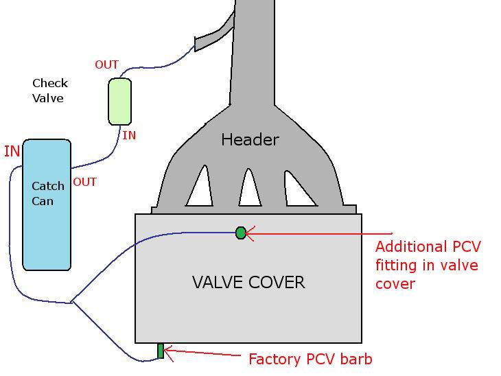

    5. Crankcase Ventilation – You will need to address the PCV system, as our stock system is strictly operated by vacuum (not to mention the new intake manifold blocks the PCV port in the head). This means anytime you create positive pressure (boost), the internal PCV system stops working and your begin pressurizing the crankcase with trapped exhaust gases. This can lead to blown seals, head gaskets, robbed performance, as well as an overall strain on the motor.
    A catch can system is great way to address this. You would run the vent barb on the valve cover to a catch can, then from the catch can you run through a check valve and to a vacuum source (easiest source being your throttle body adapter). The check valve will ensure you donʼt pull any of the exhaust fumes back into the intake tract, and running back the intakeʼs vacuum will ensure that you always have vacuum operating the PCV.
    A while back, SweetnessGT made a great write up for LD9/Ecotec PCV modification. I suggest reading it.
    You may also choose to add extra vents to the valve cover (as I am) to tee into the catch can feed. This is as simple as drilling and welding a fitting the valve cover. You could also drill the oil fill cap for additional venting. Metco also sells an adapter that replaces the oil cap with a 12AN fitting, to plumb to the catch can.
    There are a lot of catch cans on the market, I suggest using a baffled can, itʼll do a much better job catching the fumes.
    You could also get into electric vacuum pumps like used on larger race applications, though I for our purpose, I canʼt see them being worth the large expense.
    Commonly asked question; Can I just vent to atmosphere? NO. The Ecotecʼs PCV system is designed to be run by vacuum, and will only function that way.

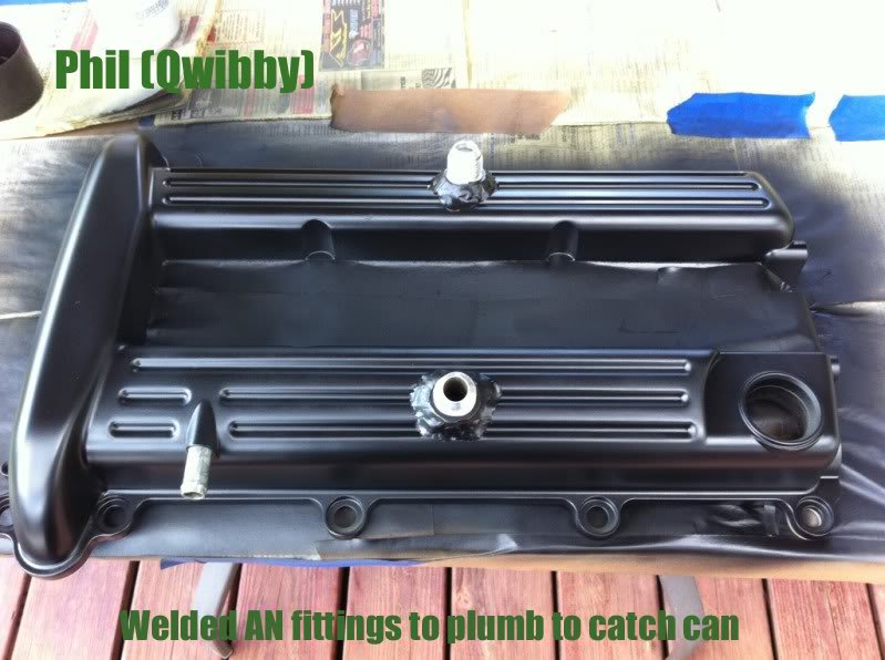

    Some examples of additional PCV:

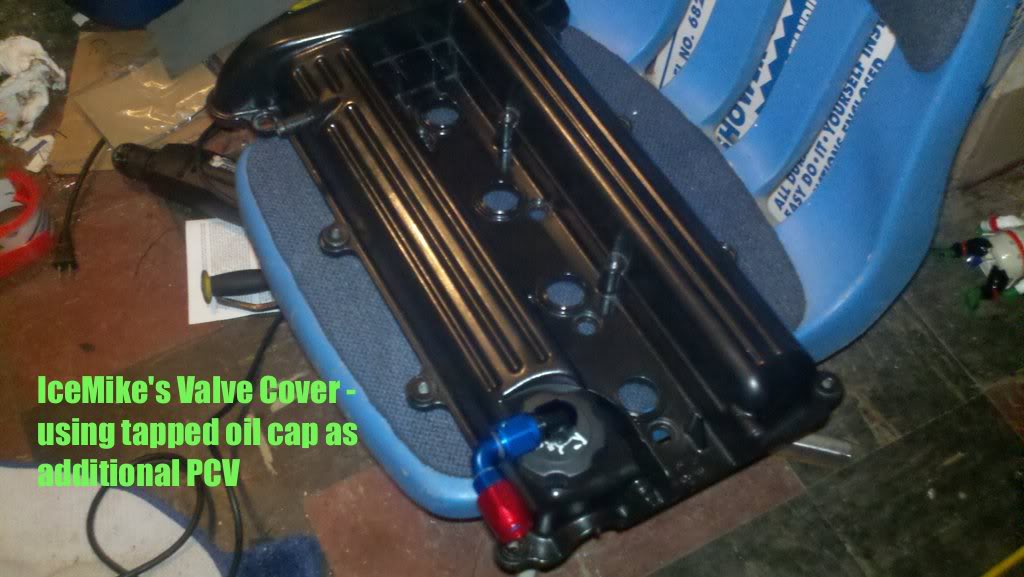

    Philʼs (Qwibby) valve cover with additional fittings welded in. These will get plumbed to the catch can.

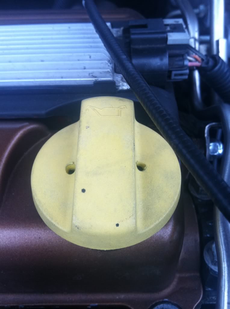

    Icemikeʼs set up, using the existing PCV barb, as well as tapping the oil cap with a fitting:
    Venting the crankcase to the exhaust is just another option. Iʼm not 100% sure, but I feel the Cobalt SS/SC may use an additional vent into the exhaust. To better explain…the reason we plumb our catch can into the intake tract is so there is always vacuum (again, our internal PCV system is designed to work only by vacuum, once you hit boost, vacuum stops and the system can no longer “breathe”), but even with baffled catch cans and check valves, Iʼve still noticed a bit of oil residue around the throttle body. I donʼt want to be sucking that through the blowerʼs rotors, and through the manifold where it could stick to the cores.
    In a normal n/a setup, itʼs ok to run the return pcv line right into the manifold, as any unused gases and residue will just be sucked right back into the combustion chambers and incinerated.
    So, if we evacuate right into the exhaust line, you can burn up the unused gases without fear of returning them through the blower and manifold. Not saying this is better or the right way to do it, just another alternative to look at.
    My initial setup was running the stock VC barb to a catch can (pulling vacuum from throttle body adapter), and venting a spare oil cap. My new system will vent from the valve cover into a baffled catch can, through a one way check valve, then into the exhaust…kind of a wastegate for superchargers for lack of better terms. Iʼm not sure yet if Iʼm going to just weld a fitting to my downpipe and run a braided line, or actually bend a small stainless steel line, welded to the downpipe, that will come up to the firewall with a fitting to run a line to.
    Drilled Oil Cap:

    1. Cooling system – A good cooling system is a must not only for getting the best performance from your supercharger, but also maintaining safe temps in the motor. Thereʼs a large aftermarket when it comes to cooling.
    Dual Pass Heat Exchanger – This is a replacement endplate with 1 inlet and 2 outlet, and changes the flow pattern of the cores. This combined with a quality heat exchanger can make a solid cooling system. ZZP, OTTP, and GM Racing all make versions of the dual pass.
    Plumbing when using a dual pass endplate:
    ZZP Single Pass Manifold – This is a full replacement intake manifold, my understanding is that all 4 cores are faced the same direction so the water is only making 1 pass straight through.
    Heat Exchanger – While the Cobra h/e is a popular choice, there are much greater options. There are single and dual pass cores, dual obviously being the most efficient. The ZZP S3 is a very popular choice, as well as the OTTP Stage 1 (just slightly smaller than ZZPʼs). CX Racing makes similar units, though I am unsure of their quality. Fluidyne is a very reputable name in the Mustang crowd, and they make some pretty ridiculous heat exchangers. Fair warning, most of the h/eʼs are HUGE, and may take some modding to fit behind a J-bodyʼs bumper.
    Pump – The stock pump seems perfectly acceptable, as it pumps 4-6gph, and the recommended rate for an application like ours is 5gph. If you do choose to upgrade, Mezaire makes several options.
