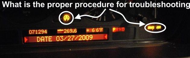

    Το γνωστό πρόβλημα της μονάδας, που κάθε μέρα το πετυχαίνω όλο και τακτικότερα. Λογικό βέβαια για κάποιες σειρές που κουβαλάνε πάρα πολλά χρόνια στην πλάτη τους.
    Στο συγκεκριμένο thread που μπορείτε να διαβάσετε εδω (με πολύ όρεξη) : https://www.bimmerfest.com/forums/sh...=356272&page=1 έχει γίνει μια καλή κουβέντα
    Ενδεικτικά μερικά posts
    Oh my. My 2002 BMW E39 has these three lights lit on my instrument cluster:
    - Triangle (is it ASC or DSC?)
    - Brake
    - ABS
    I see there are lots of threads on this so I'm reading through them, but, they all seem to know already if it's ASC or DSC they're dealing with.
    Am I dealing with ASC or DSC?
    ASC (automatic stability control) apparently senses 4-wheel differential speeds during cornering and cuts the engine power via a second throttle butterfly valve to help keep you from oversteering and spinning out in wet/snowy/unfavorable conditions. It may also apply the rear brakes lightly in some situations. It apparently doesn't touch the suspension at all. It has been described as ABS in reverse. Reputedly, while ABS controls the braking force at all four wheels, ASC + T controls the power delivery of the engine, and the way the rear differential distributes torque between the two back wheels only.
    DSC (dynamic stability control) in contrast, is apparently a suspension-control system which goes beyond Automatic Stability Control + Traction by monitoring steering wheel movement, vehicle speed, transverse acceleration and yaw to register imminent instability when cornering. DSC then intervenes via the engine management system reducing drive torque and activating wheel brakes when necessary to keep the vehicle stable.
    Having said all that, how do I know if my 2002 E39 has ASC or DSC?
    (I think it's ASC but I need to know before beginning my troubleshooting.)

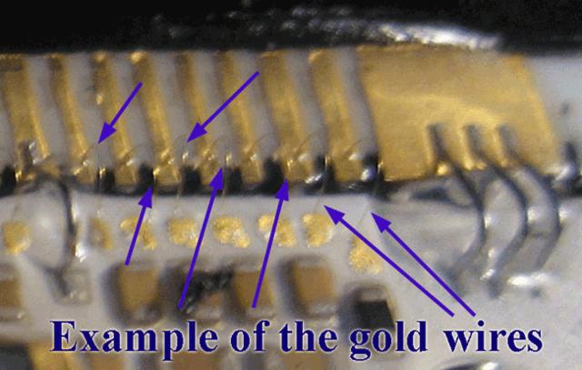

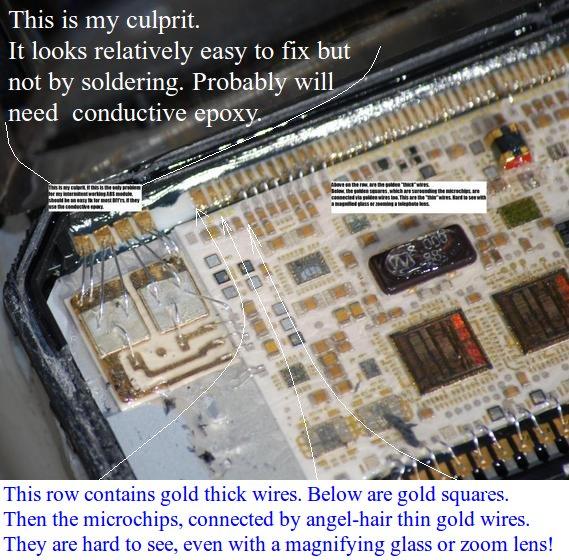

    BTW, we need to find out HOW they reattach those wires (solder or conductive glue) so we need someone to ask them while their ABS control module is on the test bench, especially if they have a WRE RP (wire repair?) performed.

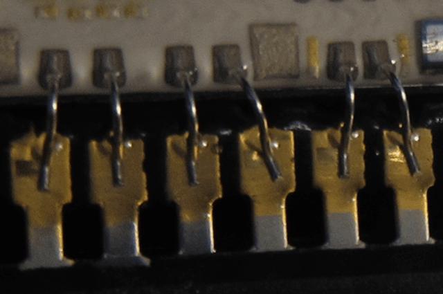

    BTW, there are some who say in the autopsy thread that the silvery colored larger wires are not actually steel; but I call 'em steel because the original Russian rebuilders in the references said they were steel (a magnetized needle would confirm that rather quickly, either way).
    My guess is the wire repair was probably around here:
    - removing "snot-like" goo from ABS circuit board <- ΠΟΛΥ ΣΗΜΑΝΤΙΚΟ!
    Also, your experiences seem to mirror some of what we've reported, anecdotally, as shown below:

    they are not steel and way to flexible for steel.
    Very interesting!
    For some reason, I hadn't seen your post until now.
    The fact the wires may be aluminum will be useful for this ABS control module wire-repair thread:
    - removing "snot-like" goo from ABS circuit board Quote:
    Originally Posted by geobrick
    The small wires are very likely to be gold and the larger silver color wires are either silver, aluminum or even platinum. See this pdf file from "heraeus contact materials" as a starting point. It's a company that makes wire for integrated circuits.
    The bonding method is probably done by the wiring machine using some kind of highly localized heat as the wire is being pushed onto its contact pad). There may even be YouTube videos that demonstrate the process. There's a section in that document that talks about aluminum plated gold wire: "For special applications in which the reliability of gold is a "must", and where bonding at room temperature is obligatory, Heraeus offers aluminum coated gold wires.
    The aluminum coating comes as an extremely thin layer. Aluminum coated bonding wires are a superior solution in order to improve the resistance in cycling tests, e. g. for automotive applications."
    Here's another very informative link about the bonding process. If this is what's being done in our brake modules, then we just need the heat from the tip on a soldering iron to repair the bond (without any solder).
    Now if I could only find the bad wire on mine...
