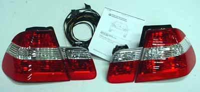

    Everyone can skip this DIY and go buy the "retrofit kit" provided by BMW. The retrofit kit cost a little under $400 and comes with everything you need to retrofit your car with the latest sedan tail lights. The kit has the tail lamps, trunk lamps, bulb housing for both trunk and tail, wiring harness for both tail and trunk lamps, and a instruction guide.
    However, for those of you that bought the post-facelift tail lamps instead, this DIY will help you with your retrofit project.
    Personally, I rather buy the post-facelift tail/trunk lamps than the retrofit kit. I bought my tail/trunk lamp set from SAM at auto-talent for $230 shipped! It is OEM.

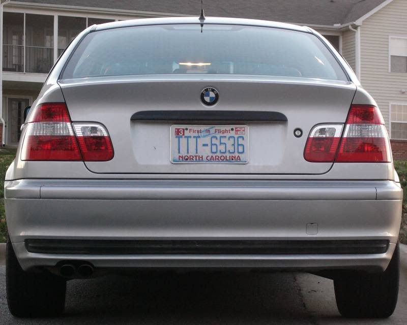

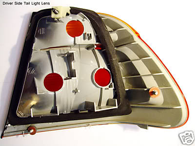

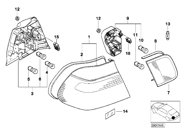

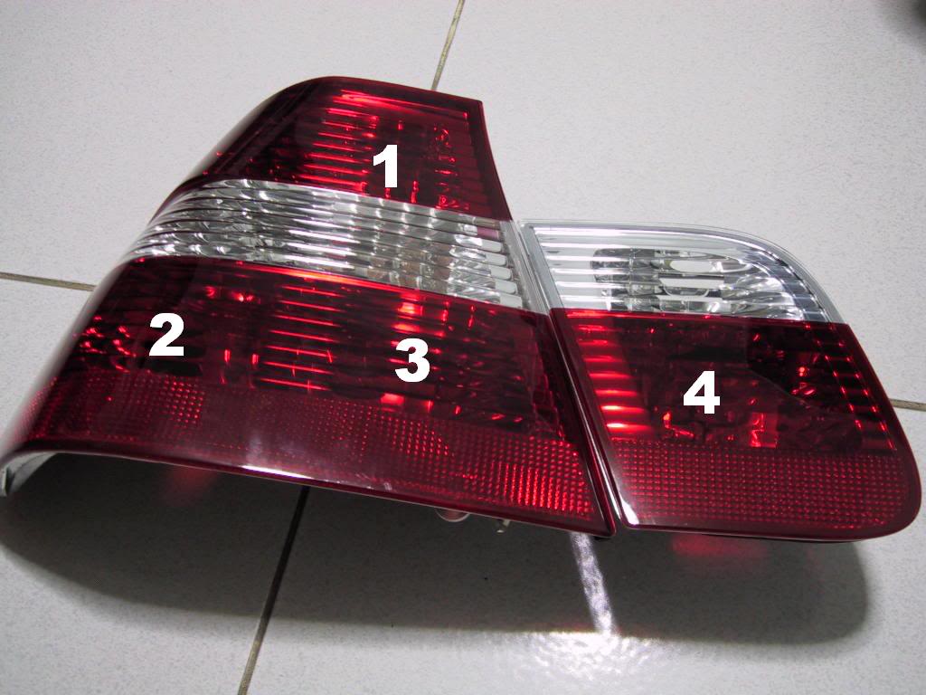

    -There is no dimension difference between the post-facelift and pre-facelift tail lamps
    ^^^ Post-facelift ^^^

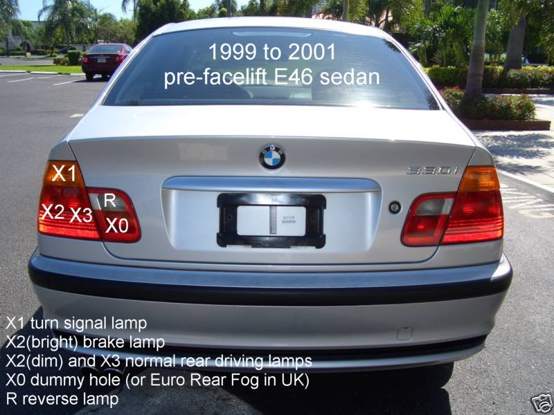

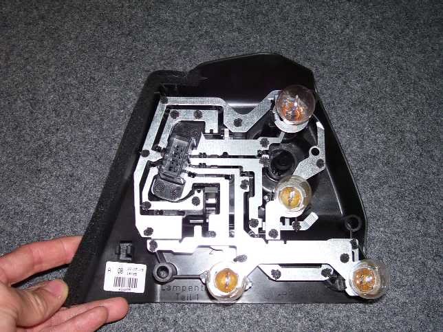

    - The physical difference is that the post-facelift tail lamps are divided into three section (RED-AMBER-RED or RED-CLEAR-RED). The pre-facelift sedan is divided into two section (AMBER-RED or CLER-RED).
    ^^^ pre-facelift ^^^

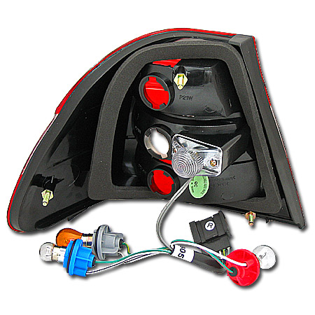

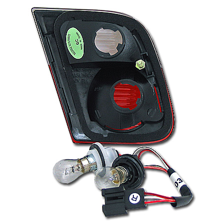

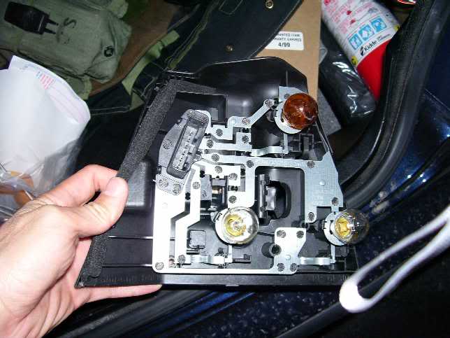

    -The electrical difference is that the post-facelift uses 4 bulbs and the pre-facelift use 3 bulbs
    ^^^ Post-facelift bulb housing ^^^
    ^^^ Pre-facelift bulb housing

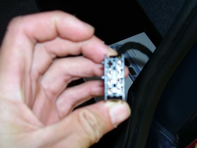

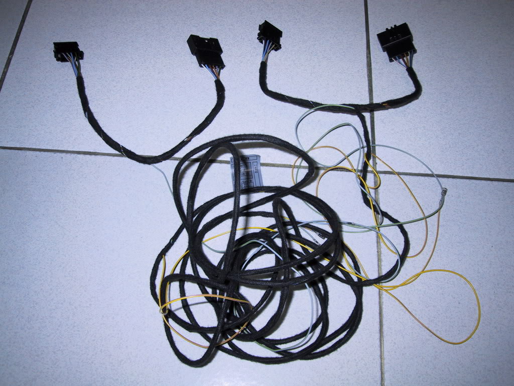

    -The wiring difference is that the post-facelift uses a 8 pole connectors w/7 brushing contacts/wires. The connectors/plug for post has two columns. Each columns has 4 pole each.
    ^^^ Post-facelift plug/connector ^^^
    The pre-facelift uses a 6 pole connectors w/6 brushing contacts/wires. The connectors/plug for the pre has one column with 6 pole running in single file line.
    ^^^ Pre-facelift plug/connector ^^^
    The biggest issue is the wiring and the LCM lights out error. However, I have a solution for that. I will address that issue later on.

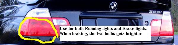

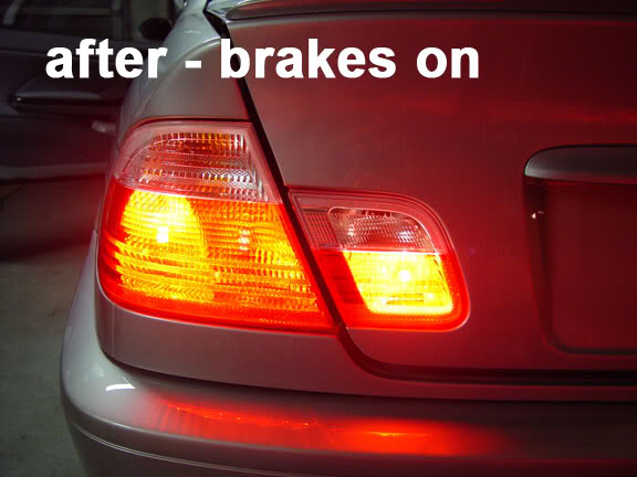

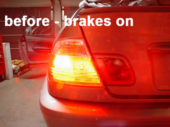

    The post-facelift lighting scheme is different.
    The bottom portion tail lamp and the bottom portion of the trunk light is use as your running lights. The top portion only illuminate when you brake

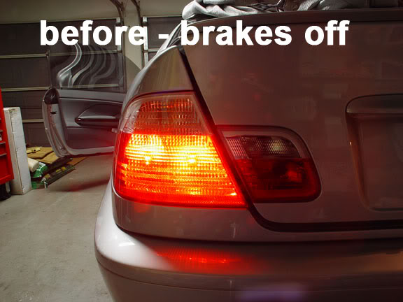

    The pre-facelifted lighting scheme is as followed:
    Both the bottom portion is use as the running lights and brake lights. When braking, the light bulbs illuminate brighter because they are dual filaments bulbs. The bottom portion of the trunk light is only use a rear fog lights (see my DIY for PRE-FACELIFT rear fog lightretrofit)

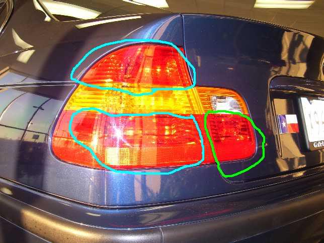

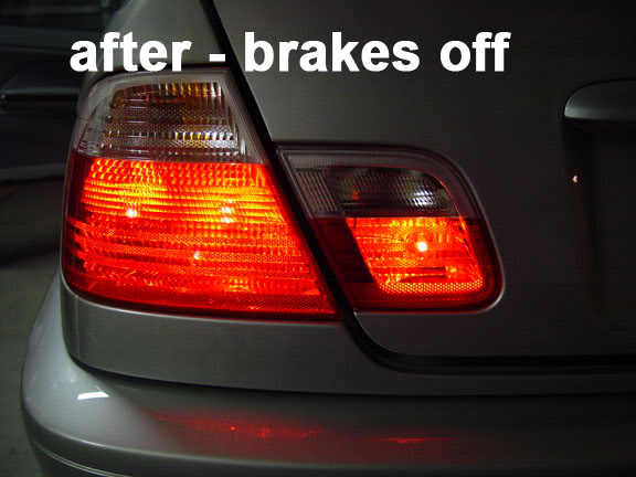

    PART 2

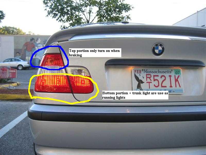

    Inorder to bypass the LCM issue, my itent is to use the top and bottom portion (blue circle) as both my brake and running lights.
    The middle section will only be use as my turn signal.
    Additionally, I will use the bottom portion of my trunk for REAR FOG LIGHTS only.

    I will do the best I can here explaining the wiring (not near my car right now). Based on this picture of the pre-facelift bulb holder, there are six different pins and 6 wires to deal with.
    I will start explaining the wiring from the top and work my way down.
    1) Top pin/wire - not sure what this is for, I have to check my car with a voltmeter
    2) 2nd pin/wire from top - Positive for the turn signal - this gets wired to the positive for the facelift turn signal
    3) 3rd pin/wire from top - Ground wire for all lamps - this is connected to all ground (-) wires on the new facelift lights
    4) 4th pin/wire from top - Positive for the light inside the trunk - connect to the positive for the light inside trunk for facelift light
    5) 5th pin/wire from top - Positive for parking light (this is a parking light ONLY, not a brake) - for the new facelift lights, this wire gets hooked up to the bottom row of red (the two lower bulbs in the new light) so that the bottom row is only for parking lights. You have to tap this wire or split it to get a wire to both light bulbs.
    6) 6th and last pin/wire from top - Positive for the parking AND brake light - connect this wire to the TOP red light in the new facelift light. This will serve as a parking AND be the ONLY brake light. This will operate EXACTLY like the OEM facelift version during the DAY, but will operate as a parking light also at night (different from OEM since the top red light serves only as the brake light)
    When you have the lights on, all the red parts of the facelift light will light up, the top red and the bottom 2 red. When you press on the brake, ONLY the top red will light up and it will look just like the OEM facelift.
    To get the parking light in the trunk to work, just tap a wire into the license plate lights and you should be good to go. I haven't done this yet but I will when I have the time and will post my results.

    Thanks to Luckysnafu, I am going to revised my wiring plan:
    I am going to use the top and bottom portion for running/parking lights.
    The middle section is going to be used for turn signal
    the top portion will be used for BRAKE lights (and running/parkling lights)

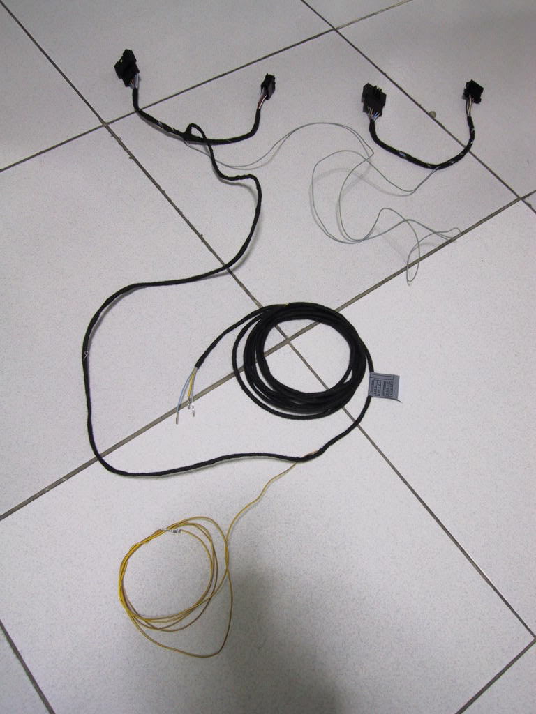

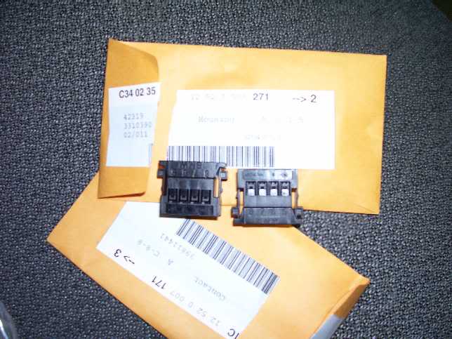

    Below is a picture of the plug/connector you need to buy from the dealers
    They run for around $0.75 each. You need to buy some brushing contacts too. You need a total of 14 brushing contacts. You can use your pre-exisitng contact from your pre-facelift bimmer but it requires some minor modification. The brushing contact cost $1.37 each
    Plug housing: 12-52-7-505-271
    Contact Brushing: 12-52-0-007-171

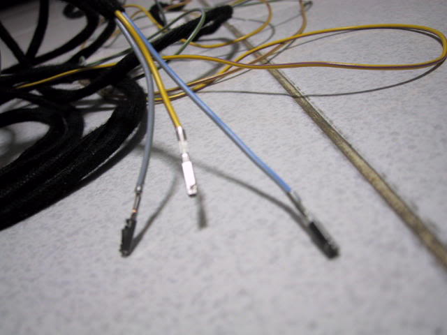

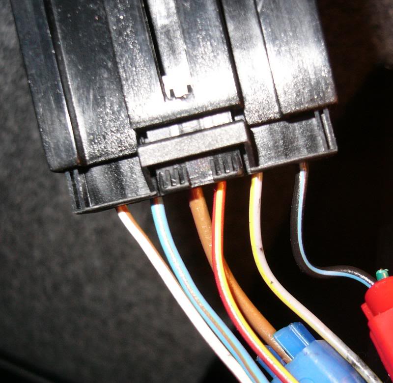

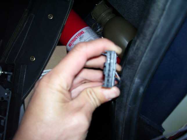

    I took some pictures of the wires and can tell you what colored wires go to which lights for the pre-facelift tail lights. I do not have a new facelift bulb holder or wire connector so I can't tell you which wires to hook everything up to, but you should be able to figure it out by following the pins on the bulb holder. ADA - were you able to buy the 8 pin facelift plug at the dealer? If so, what is the part number, I can't find it on realoem.com - I am thinking of buying the facelift bulb holders and lights.
    Pre-facelift tail light wiring:
    Drivers Side Wires
    Pin 1 - White with a brown stripe - Ground for the interior trunk light
    Pin 2 - Blue with a green stripe - Positive for turn signal
    Pin 3 - Brown - ground for parking and brake lights
    Pin 4 - Red with a yellow stripe - Positive for the interior trunk light
    Pin 5 - Gray with a purple stripe - Positive for parking light only
    Pin 6 - Black with a green stripe - Positive for the combined parking and brake light
    (pin numbers could be reversed - I didn't check on the plug)
    Picture of plug with wires
    Passenger Side Wires
    Pin 2 - Blue with a brown stripe - Positive for turn signal
    Pin 5 - Gray with a yellow stripe - Positive for parking light only
    Pin 6 - Black with a blue stripe - Positive for the combined parking and brake light

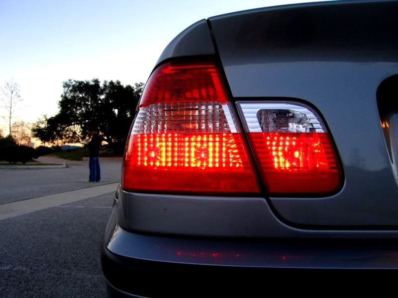

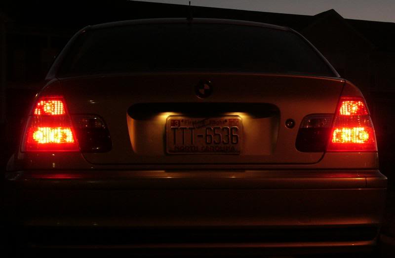

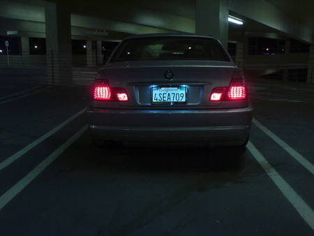

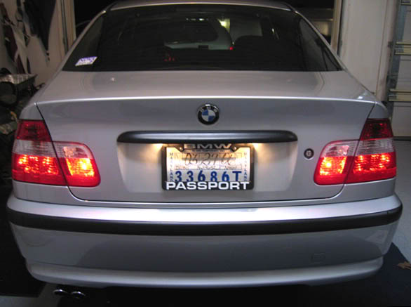

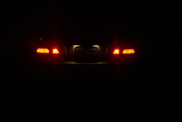

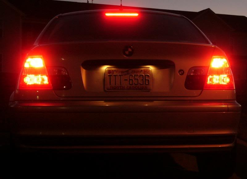

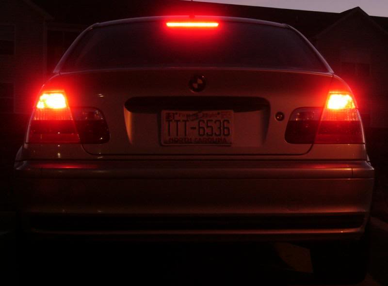

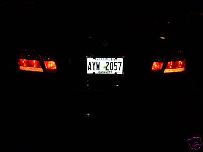

    Here are some pictures of how my tail lights look and work. My tail lights are not OEM, they were from ebay and do not have a bulb holder, the lights are integrated. It is a plug and play unit that just plugs into the existing 6 pin plug.
    Tail Lights
    Brake Lights Only
    Parking Lights Only
    Brake Lights with Parking Lights
    Sorry for the crappy pictures, my digital camera sucks at night

    1) My running/parking lights seems brighter than the brake light (when brake is not activated)?
    2) When activating my brake, my brake light is as bright as my running lights. I figured that my brake light would be brightest but it is not. Again, when I depressed the brake pedal, the brake light has the same intensity as the running lights.
    Quote:
    Originally Posted by luckysnafu
    1) My running/parking lights are also slightly brighter than my brake light. This is because the top light is only getting 6 volts or so and the light is underpowered. The bottom lights are getting a full 12 volts, but they are smaller bulbs with smaller wattage so they are slightly brighter. I was thinking of putting a resistor in line with the top bulb to try and get it off when the parking lights are on but still work for the brake light.
    2) My brake light is much brighter than my running/parking lights when it is on. I have a higher wattage bulb in the top which is very bright when the brake is on (full 12 volts).
    The pictures don't really show the brightness since my camera does not take good pictures at night.

    As I said in a previous post, the bulb wattage is the issue. You need the 5w filament in a 21w/5w bulb to get the brightness closer.

    Bekkers has a OEM Retrofit Kit (where I finally got mine)
    https://www.bekkers.com/Merchant2/mer...Category_Code=
    Or, you can buy just the taillights from bekkers and then buy the cable harness at the dealer. Part # 61-1-20-140-220
    Also, here's the BMW retrofit instructions:
    https://www.bigpatsfans.com/e46_tail_retrofit.pdf

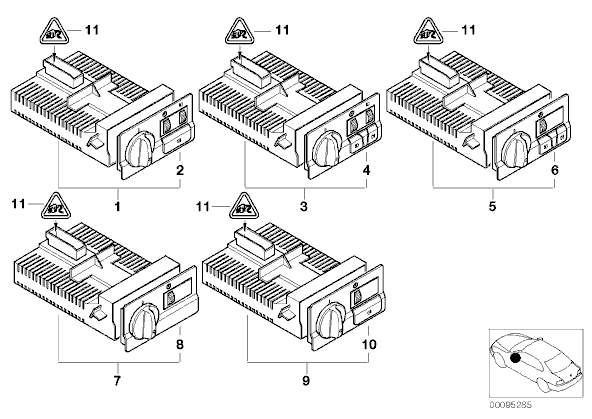

    One DIYer bypassed this lack of a rear fog lamp issue and added it to his pre-facelift tail. To do this he simply purchased a Euro rear fog bracket w/ bulb and wired it to operate as both a normal driving lamp & brake lamp. See pics below;
    And he bought everything inside the part labeled number 9 in the picture below to obtain the rear fog bracket for his DIY.
    You can even go further and order the LKM faceplate w/ the rear fog button as seen below labeled number 4 or 6
    Command of the Rear Fog lamp adds extra brightness to the trunk lamp during normal driving so you can be seen sooner at further distances or in incliment weather by traffic behind you.
