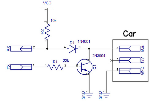

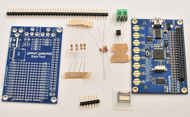

    Step 2: Make it: Parts
    Below are the parts you'll need to build your own Car Kracker - We also offer a kit that includes everything you need right here. The kit also comes pre-programmed and includes a USB cable and mounting hardware.
    Parts List
    • P8X32A + Quick Proto
    • Qty 47: Pin headers
    • Resistors;
      • 1x 22k ohm, 1/4 Watt Resistor
      • 5x 10k ohm, 1/4 Watt Resistors
    • Diodes;
      • 1x 1n4148 Diode
      • 1x 2n3904 BJT Transistor
    • SD Card slot (Hirose DM-3D-SF)
    The kit comes pre-programmed, but if you're building it yourself, you can grab the sourcecode right here. Here's the circuit we're going to build;
    Check to make sure you have everything you need, warm up your soldering iron, and continue to the next step

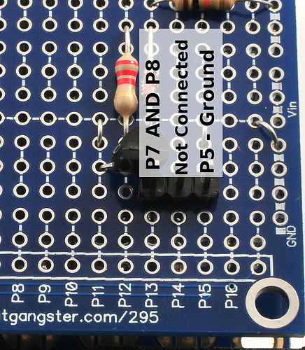

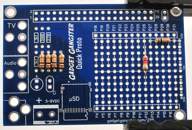

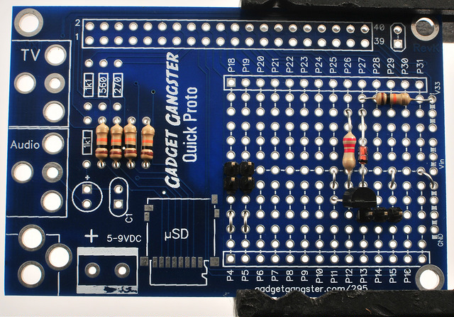

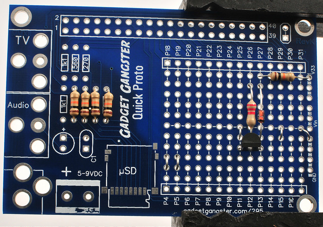

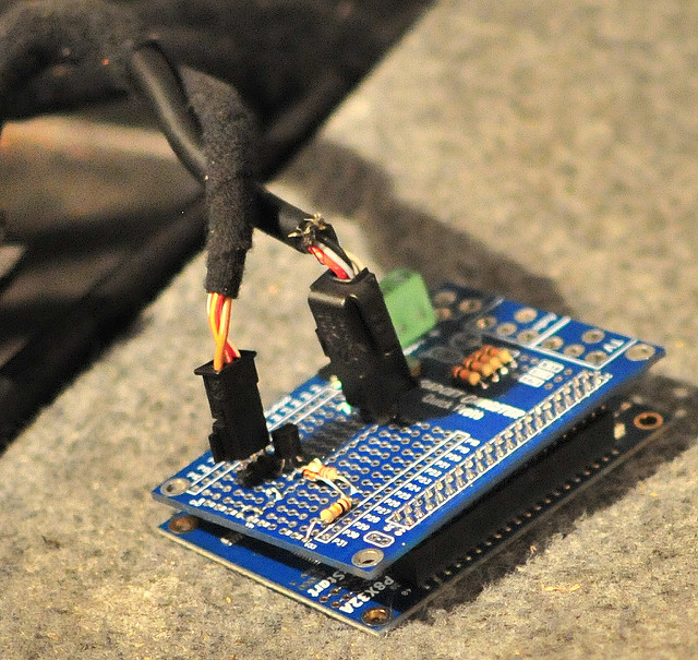

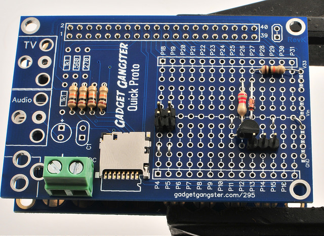

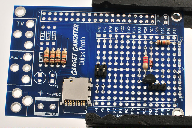

    Step 3: Make it: Assembly
    Let's start by adding the 10k Resistors, they're marked with Brown - Black - Orange stripes and the 22k resistor;
    Save the extra leads as you trim them off each resistor.
    The diode and transistor - note the black stripe on one side of the diode. That side points down, as shown in the photo. The flat side of the transistor points down, too;
    Using the extra wire from the resistors, add 5 jumpers to the board, I've marked them in the photo
    Add the audio and bus connectors;

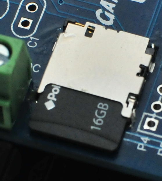

    Now the microSD card slot - note that you don't have to add this unless you want the audio jukebox features.
    Now the power connector and finally the header. It's easiest to first insert the header pins into the P8X32A board, then put your Quick Proto board on top
    Assembly's all done. Let's test it out!

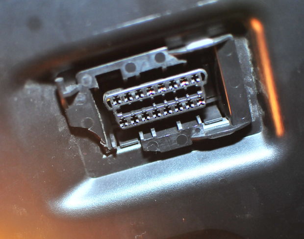

    Step 4: Connect to your Car
    First, let's locate the data bus on your car;
    1 - The Trunk
    Even if your car didn't come with a CD changer, it's nearly always pre-wired for it. Open up your trunk and explore behind the felt panel on the driver's side. You'll find three cables - The 3 pin cable is your bus connection, and the 6 pin cable is the analog audio input to your stereo. You don't need the big 20 pin connector.
    Plug the 3 pin and 6 pin cables into your Car Kracker;

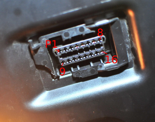

    2 - OBD2 Connector
    The Trunk connection lets you access all the accessories in the car, but not the Engine Control Unit or Transmission Control Unit. To access the engine and transmission, you'll need to connect through the 'On Board Diagnostics' connector. It's in the car under the steering wheel, and looks like this;
    Use a bit of jumper wire to connect each pin of the Car Kracker to these OBD pins;
    The leftmost pin on the Car Kracker connects to pin 7 and pin 8 on the OBC port. The middle pin doesn't get connected. The rightmost pin gets connected to pin 5.

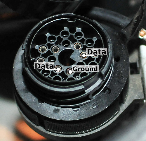

    3 - Diagnostic Connector
    Some cars will also have a diagnostic connector under the hood - mine has a huge connector which includes bus connections, and a couple other random things (like two connectors to reset the oil change reminder);
    For the BMW 'Pacman' connector, connect the two data lines to the leftmost pin on your Car Kracker, and the Ground port to the rightmost pin.
    When doing diagnostics, I usually use the Pacman connector - for audio and entertainment, I use the trunk connector.

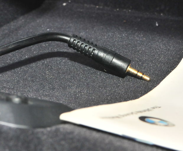

    Step 6: Using it: Audio Aux-In
    If you boot up the Car Kracker without holding a button and without an SD card, you'll enter Audio Aux-In mode. This mode lets you connect any MP3 player or even bluetooth player and listen to it on your stereo. Here's how to set it up;
    Aux-In
    The 6-pin header in the trunk connects to an analog audio input to your stereo. Unfortunately, the stereo won't tune into that audio input unless it thinks there's a CD changer connected in your car.
    The Car Kracker solves that problem by pretending to be a CD changer. Your stereo will think there's a CD changer and amplify whatever signal is coming in the analog in line. Here's how to set it up;

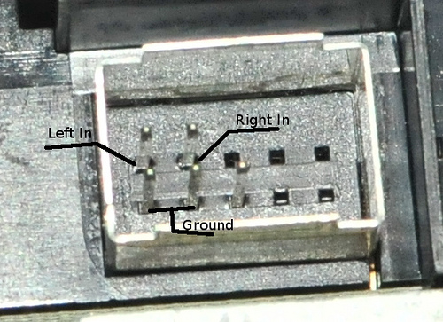

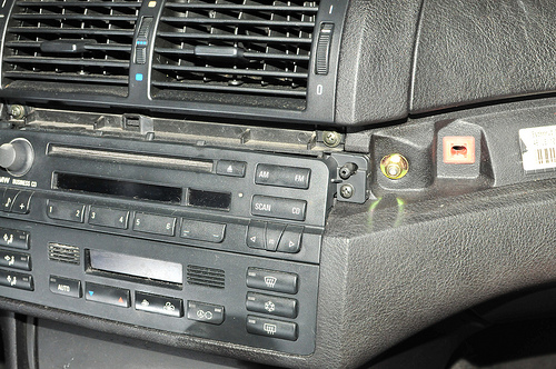

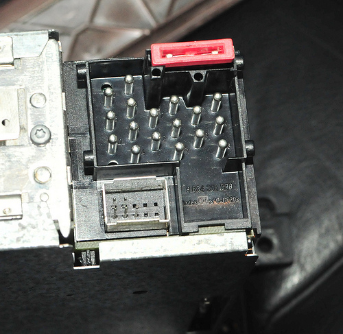

    Step 2: Headphone Jack Connection

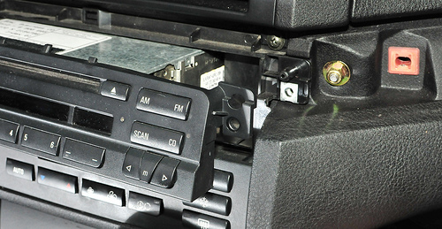

    You can connect whatever audio source directly to the 6-pin header in the trunk, although that can be inconvenient. You can use a Bluetooth A2DP adapter and play audio from your cell phone over bluetooth, or you can connect your audio source directly to your stereo. On the BMW 3-Series, you just pry off the fake wood panels on the dash with a butter knife. First the passenger side panel, then the middle panel;
    and remove the two screws holding in the stereo;
    Remove the connectors off the back and slide out the stereo;
    You'll want to connect your left channel, right channel, and ground to the pins on the bottom;
    You can run that cable out to the sunglasses box under the stereo or to the glove box.
    A few notes on Aux-In;
    • Your Car Kracker has to be powered up and connected to the car whenever you want to use Aux-input. You can power it up with 4xAA's batteries or connect it to a USB car charger.
    • Not all head units need CD changer emulation - some have a second set of audio connectors just for Aux-input. In that case, you just need to construct a cable.

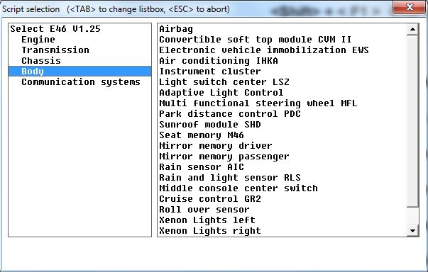

    2 - Setup the software
    The Car Kracker is going to provide a physical connection between your car and computer. You're going to run software on your computer to actually collect the diagnostic data. You have a few choices;
    INPA
    INPA is not commercial software, it can be found on 'the usual sources'. I suspect it was originally for BMW re-certification and factory testing. Downloads usually include NCSExpert, WinkFP, and a few other tools.
    INPA comes with EDIABAS, which needs to be configured. In c:\EDIABAS\BIN\EDIABAS.ini, make sure active interface is Interface =STD:OBD . Also, your Car Hacker needs to be assigned to COM1.
    With INPA installed, start INPA(_.IPO). That will load EDIABAS and INPA will pop up. Select the type of car you have and the diagnostics you want to run and you're off to the races!
    NAVCODER
    Navcoder is commercial software, it is mostly designed to read accessory bus information (Radio / lights / Nav), not really for engine diagnostics. However, it's pretty handy and easy to use, especially when you want to do things like remove the Nav warning screen or change the speed sensitive volume on the stereo;
    The free version did everything I needed it to do, but I ended up buying it just to say thanks.

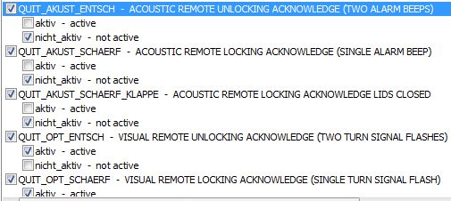

    Step 9: Using it: Dealer Customizations
    You can put the Car Kracker in diagnostics mode (Hold P7 on bootup) to make customizations to your car;
    What are customizations?
    Customizations are ways to control the default behaviors of the electronics in the car. For instance;
    • Should the nav warning screen be displayed?
    • Should the gong sound be played whenever the door is open?
    • Should there always be daylight running lights?
    And so on. Only some things can be customized, it depends on the functionality of each module. Customizations are stored even when the battery is disconnected, but they can be changed any number of times. Personally, I turned off the 'Keys in ignition' gong and reduced the level of the speed sensitive steering. Here's how to customize your car;
    1 - Make sure INPA works
    Also make sure you've installed NCSExpert, it usually comes with INPA.
    2 - Use NCSExpert to change customizations
    A full writeup on NCSExpert is up on M3 Cutters. I also use NCSDummy (on Bimmerforums) because NCSExpert is entirely in German and can be hard to understand.
    NCSExpert will generate a file (usually C:\NCSEXPER\WORK\NETTODAT.TRC), open NCSDummy and it will load that file and allow you to edit it easily. Save the edit and write the revised file back to your car with NCSExpert.

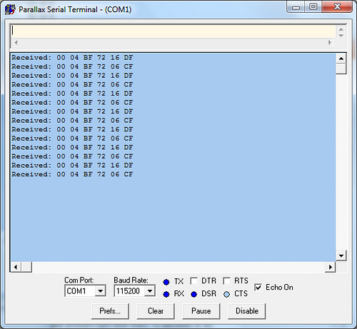

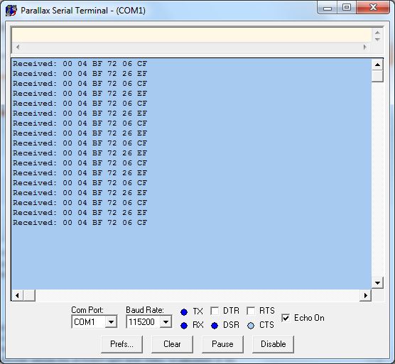

    Step 10: Using it: Bus Sniffing
    If you're an advanced user and just want to watch the data bus to see what's going on, hold down P7 on boot up to enter Bus Sniff mode. This will show you the traffic on the databus in realtime;
    Once you enter Bus Sniff mode, open up your Serial terminal program (Hyperterm, PuTTY, Parallax Serial Terminal) and connect to the COM port your Car Kracker is on at 115200 baud.
    • The first byte of the message is the source; $00 = broadcast, $3B = Nav, $BF = Global
    • The second byte is the length of the message, counting from the third byte
    • The third byte is the destination - the mapping is the same as the source addresses
    • The 4th byte begins the data itself.
    • The last byte is the checksum - it's calculated by XOR'ing each byte in the packet, here's the pseudo code;
      checksum := 0
      Repeat i from 0 to codelength
      checksum := checksum xor (BYTE[code][i])
    There is no discovery method for finding out what commands each module supports. The best way to figure it out is watch the bus while pushing buttons. The example above is what the bus does when I unlock the door with the key fob;
    $00 $04 $BF $72 $06
    From: Broadcast ($00) To: Global ($BF)
    Data: $72 $06
    Remote Unlock button pressed on Key fob
    $00 $04 $BF $72 $26
    Data: $72 $26
    Remote Unlock button released
