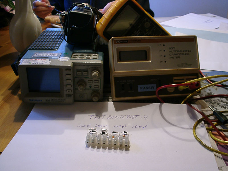

    A restorer with SRS airbag reset was needed, too, purchased from the U.S., to avoid having to go to Car & Electricity in Orebro each time the airbag light came on. And I borrowed some needed equipment from my job. Picture 2.

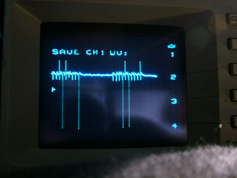

    Picture 3. Represents a flawless sensor mat in full operation without load.

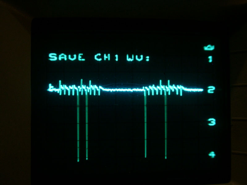

    Picture 4. Here I have replaced the sensor mat with only one diode, and one sees that it is almost exactly the same as the uncompressed mat and then probably not the airbag is activated.

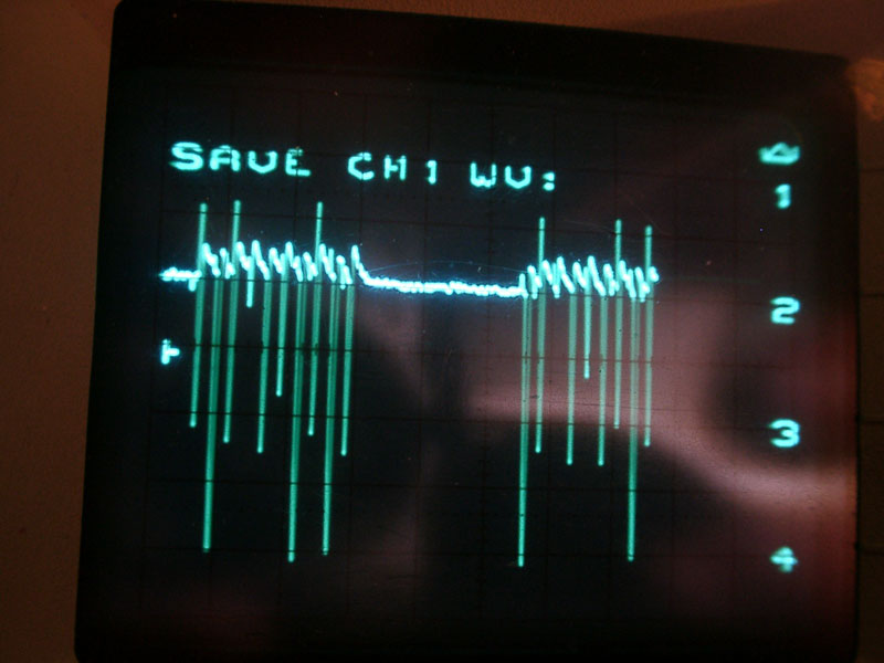

    Picture 5. How does it look when a sensor mat is loaded, a substantial difference.

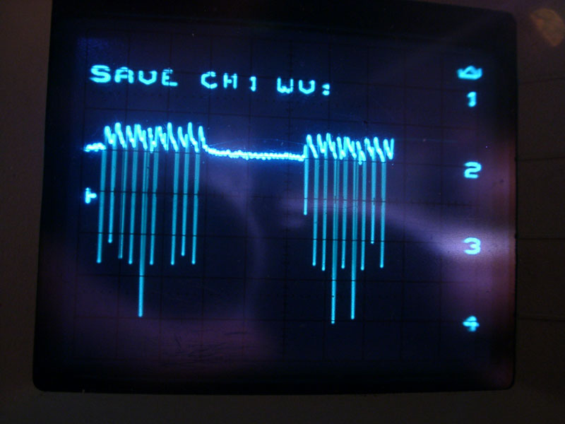

    Picture 6. Here I have replaced the carpet with a parallel diode, 100pF, capacitor and a resistor and 56kOms sweep is so identical to a loaded sensor mat so here I am satisfied with the tests and assembles this instead of the faulty mat in the car.

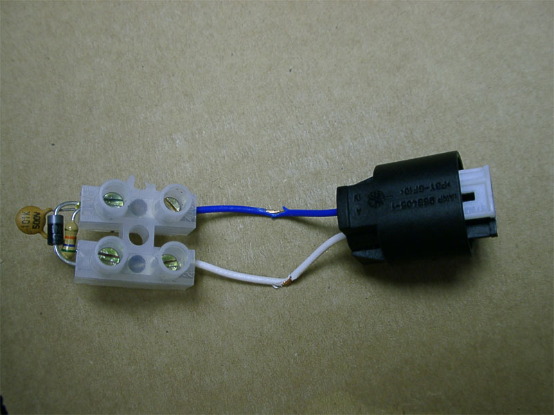

    Picture 7. The blue cable is the diode blocking direction side ie. where the line is, all mounted in a sugar cube
