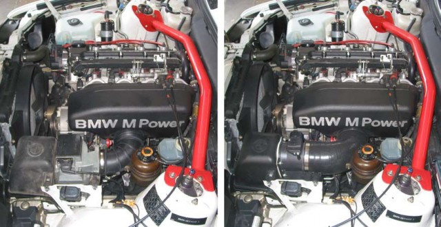

    The photo below shows a Bosch air flow meter from a BMW E30 M3 on the left compared to
    the MAF 3.5 sensor on the right that is used to replace it in the Split Second MAF Kit. Note that
    the air flow meter has lots of sharp edges and protrusions that can impede air flow. The MAF
    sensor has a smooth opening and much larger cross section.
