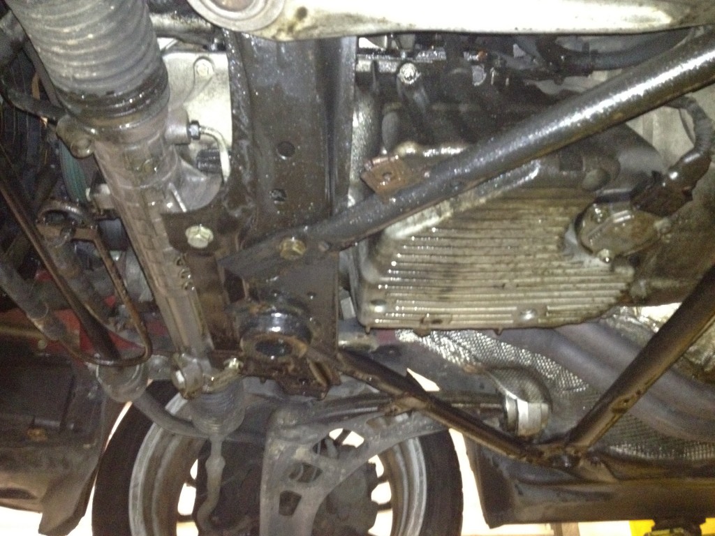

Today we have GeorginaΆs 316i in to repair the large oil leak from the oil filter housing. This problem is very common on the M43 engine and weΆve seen cars with as little as 20k miles showing early signs of oil leaking from the filter housing where it joins into the engine block.

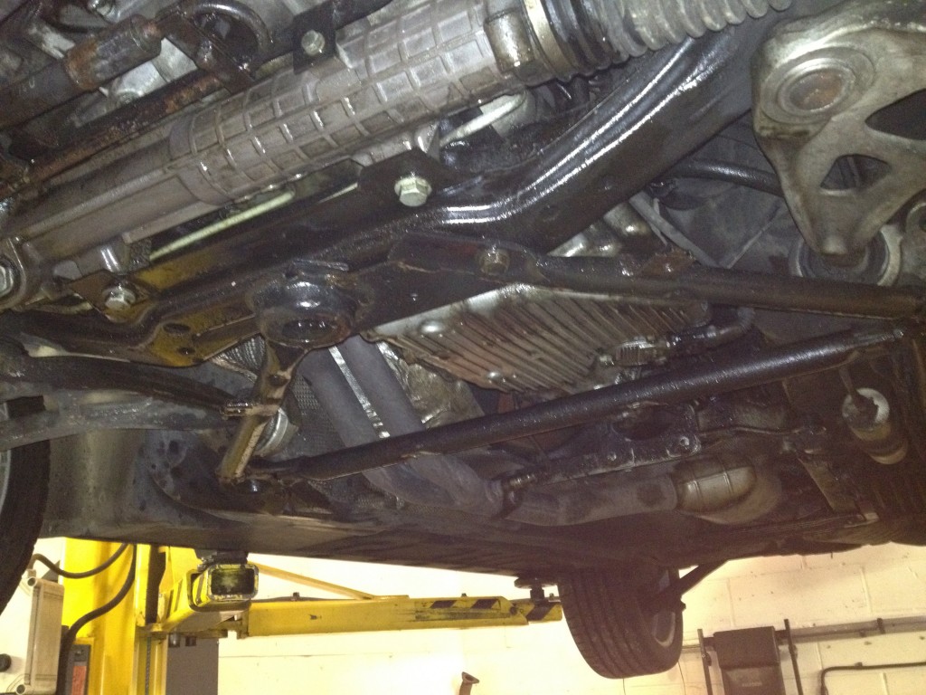

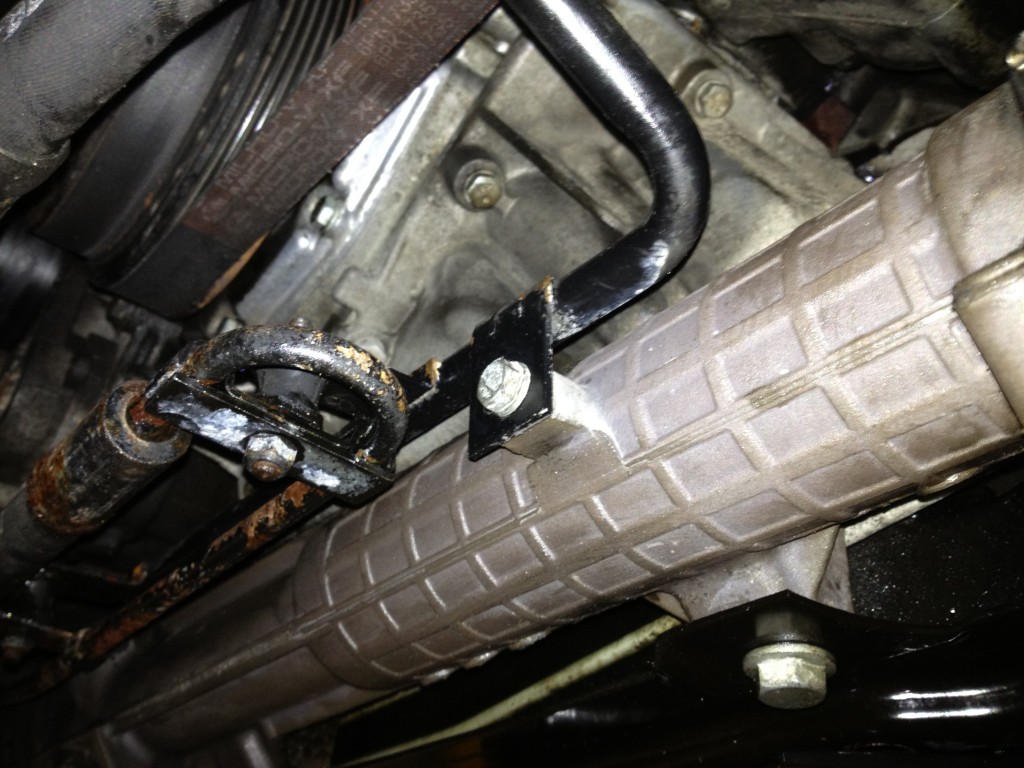

as you can see in the pictures below there is lots of fresh engine oil all over the underside of the engine.

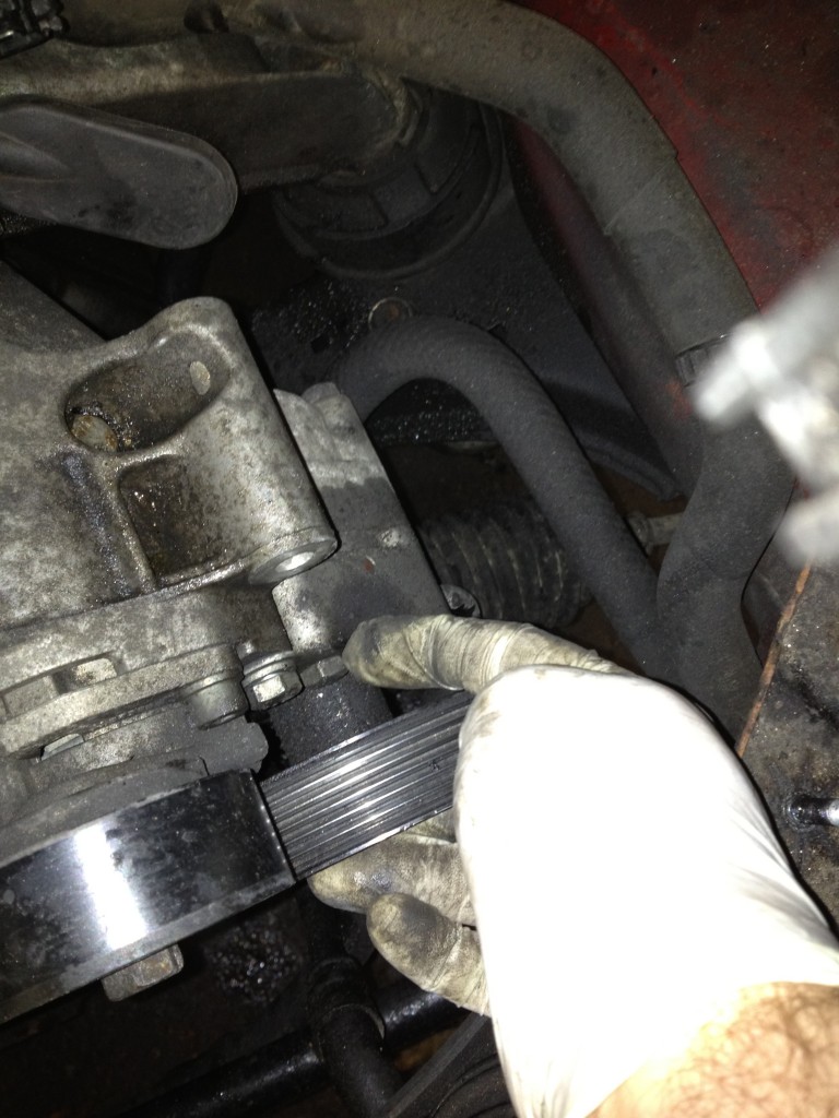

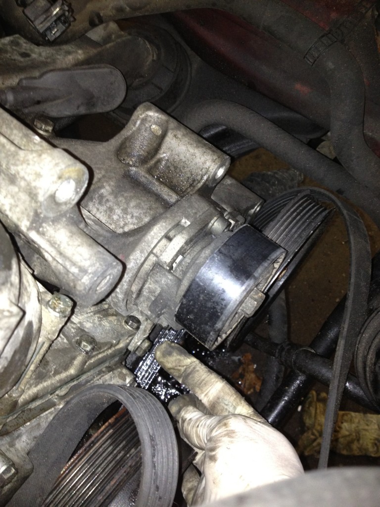

Then its time to remove the alternator drive belt using a 15mm spanner, just pull the belt off the alternator, no need to completely remove it from the car.

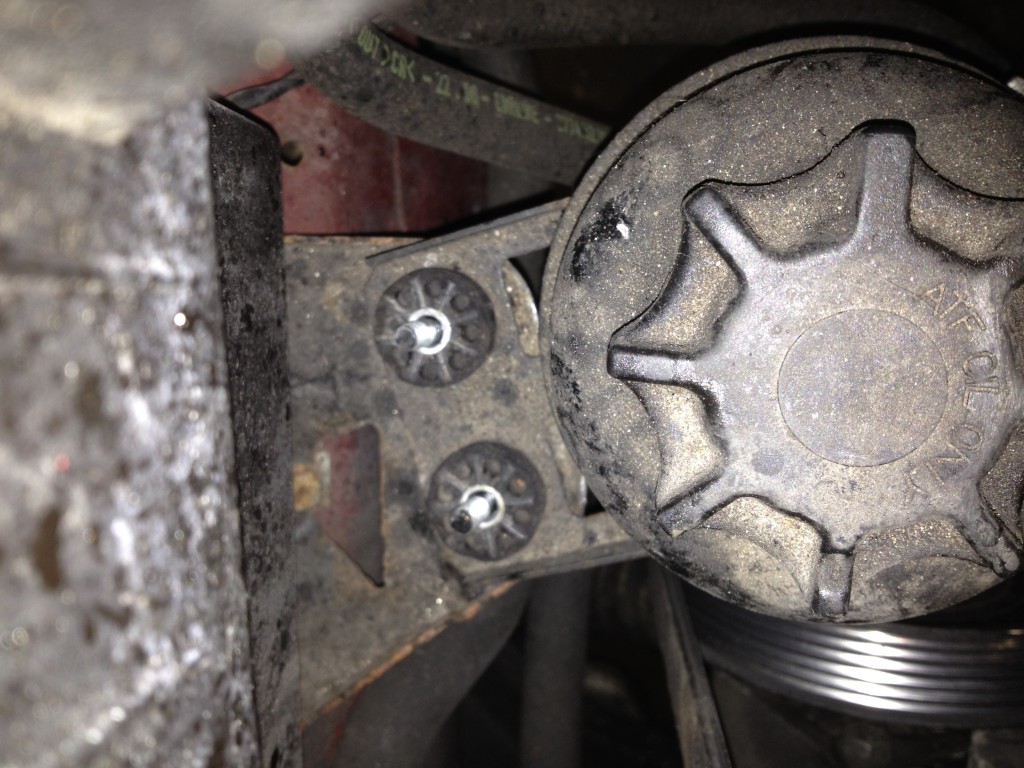

Once those 2 items are done you must undo the PAS reservoir 2 x 10mm nuts as below already removed.
lift the PAS reservoir/tank of its bolts and let it hand down and rest.

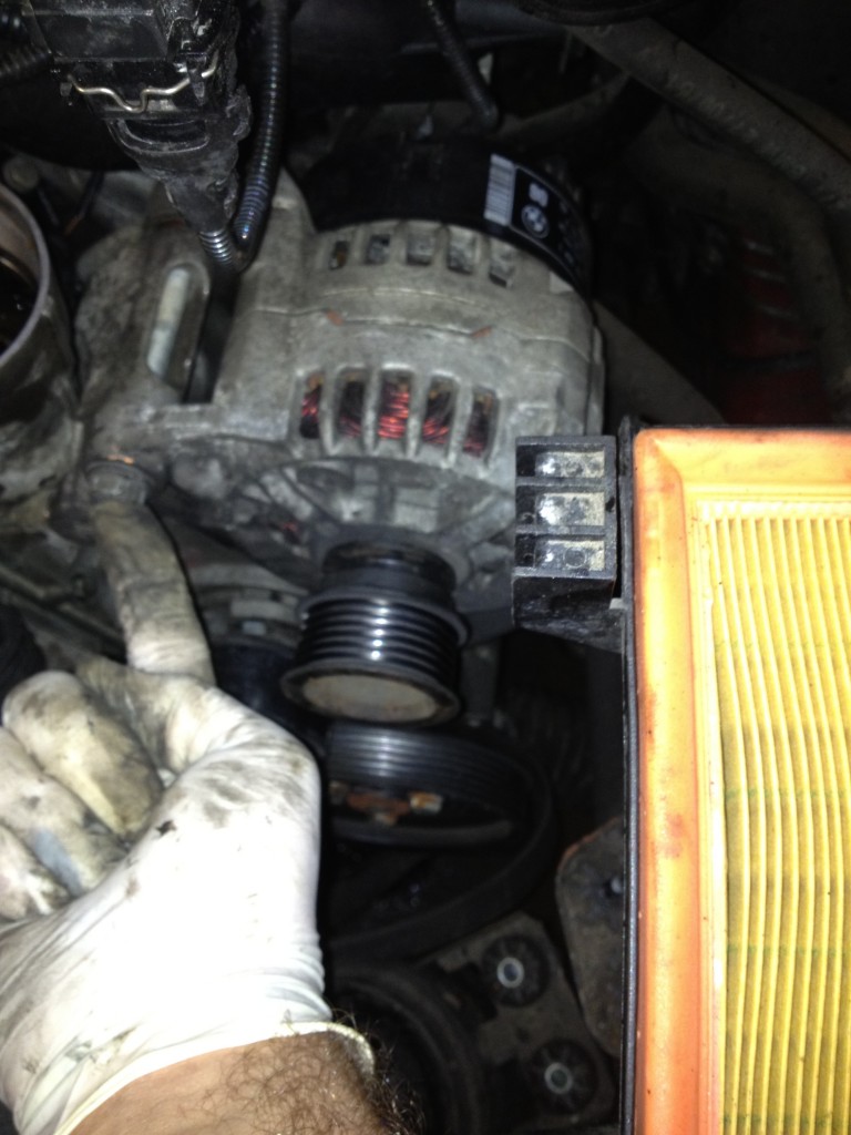

Now you need to remove the 2 x 16mm alternator bolts.
Once you have loosened the alternator you must undo the red power cable to it, ensure the battery cable is disconnected first. then unplug the electrical connector on the alternator also. Completely remove the alternator from the car.

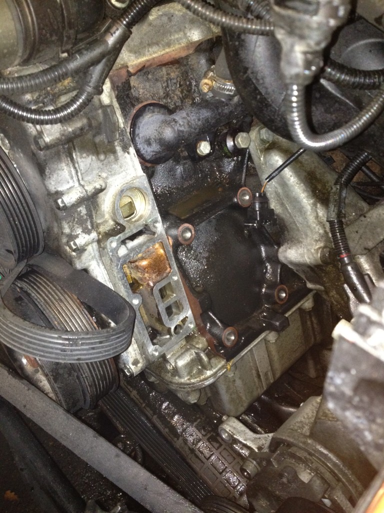

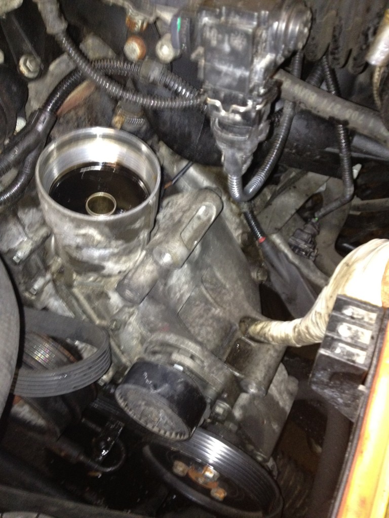

With the bracket removed you will have access to the oil filter housing. Remove the oil filter cap and the micro filter at this point if you havenΆt already done so.

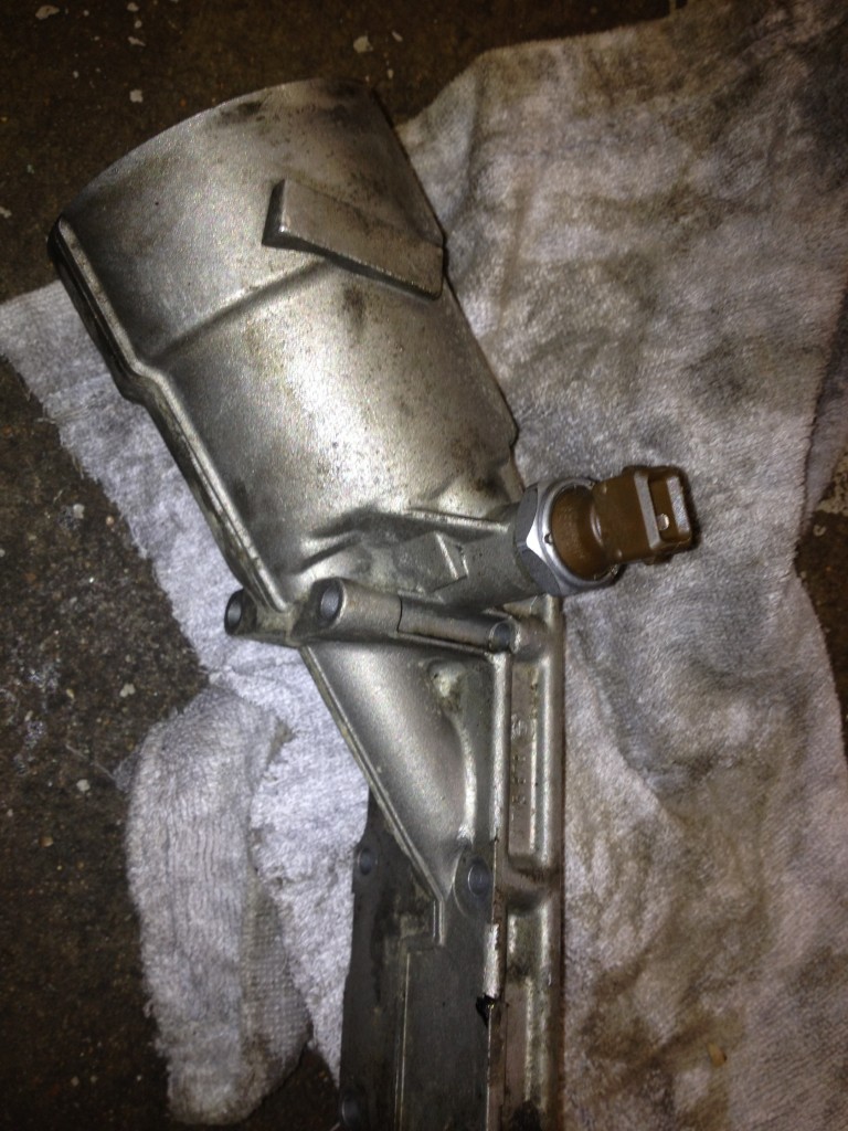

Undo the 6 x 10mm securing bolts for the oil filter housing, and remove the housing from the car as below.
Housing on floor.

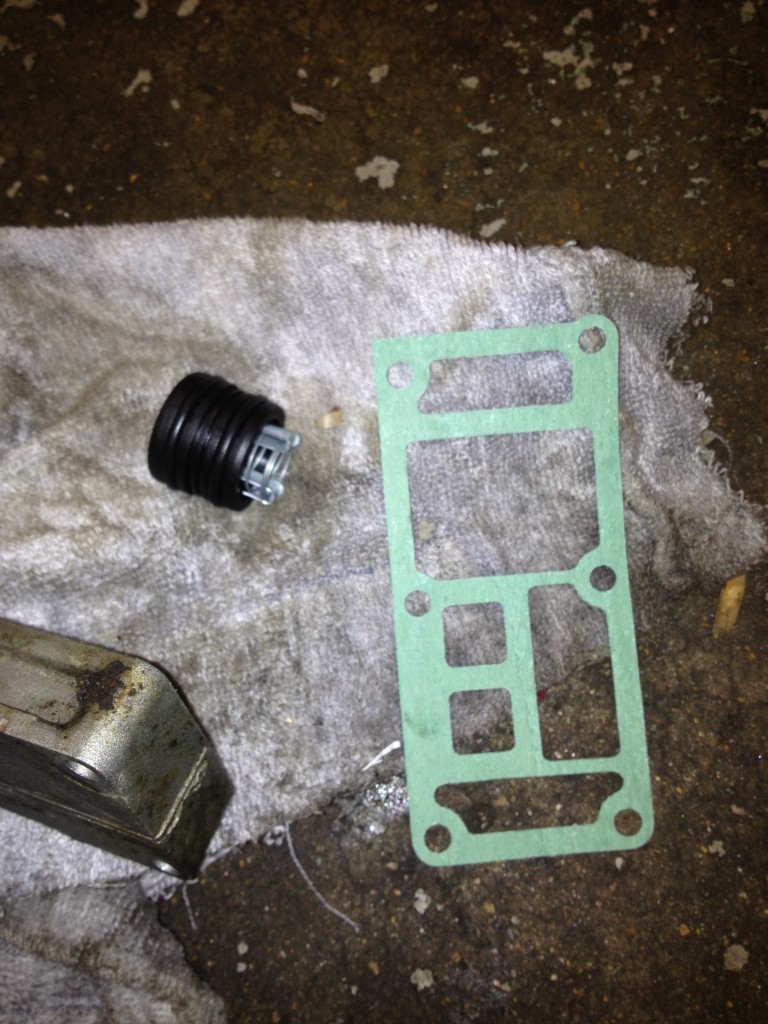

Now you need to scrap off the old gasket from the engine using a stanley blade or gasket scraper tool.
Heres the new parts – a gasket and the oil fitting with O-rings. These o-rings are the cause of the leaks, they perish and become unable to seal the oil. YouΆl find the old fitting was very loose and easy to remove.
Fit the new gasket, new oil fitting (snug fit and pops when its pushed in to place).
