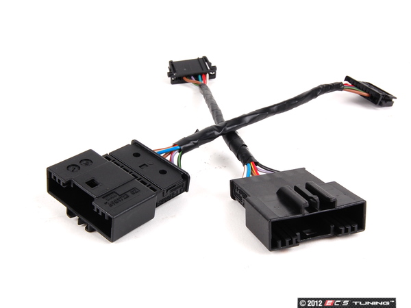

    This is easily rectified. Even though the LED tails have different electrical connectors from the halogens, BMW makes wiring harness retrofit kits. You can also buy the bulb sockets for pretty cheap. Those are the only parts that you NEED to physically plug the LED tails in. Be advised that the reverse lights that are in the trunk lid are different aesthetically. It's purely an aesthetic difference, and their functionality has nothing to do with the LED tails.

    -Retrofit wiring harness (both sides included)- 61120153650

    Question - Do I really need those retrofit harnesses for the wiring? I can't find them used, and they're like $50 at the dealer. Can't I just cut the wiring out of a part out?
    Answer - The retrofit harnesses made this completely plug and play and IMO are totally worth the cost. The ONLY other way to do it would be to cut the wiring out of a car with factory LED's, cut your connector off, and splice the wiring together. I'm not an advocate of cutting wires in cars. It's irreversible, and can get messy.
