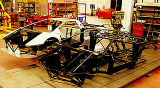

    Unlike the Ferrari F40 and Bugatti EB110 of the same generation, the unique 16 cylinder Cizeta uses no Kevlar in its construction. Its space-frame chassis was built the tried and tested way used by Italian supercar makers for 40 years. Elliptical chrome molybdenum steel tubing was welded together by hand to make up the main frame. The plumbing, water, brake lines and electricals are contained in the 72mm diameter backbone tube that runs down the centre of the chassis. The sleek aluminium body which clothes the structure was made in Turin. The car incidentally, has a flat underbody.
    The only carbon fibre you will find on this car is used for the dashboard panel. Dashboard supports are fabricated in aluminium rather than glass fibre, because leather on GRP eventually creeps. The bulkhead between the engine and cabin is double-skinned for sound and heat insulation. It works so well that you can hold a normal conversation at 110mph.

    "All the work is done here except machining. We assemble the chassis, suspension, sheet metal, engine components and upholstery," Zampolli explained. "Machining is contracted to a precision workshop which makes components for F1 engines. Buying such machines is a big investment which I don't want to get involved in. If I started the whole project again with big money to invest in machinery I still wouldn't, because I know I can get excellen work from all these local workshops without incurring the capital outlay."
    The unique cylinder block was made on special Swiss tooling, and is a single aluminium alloy casting with twin steel crankshafts running through its centre. These cranks are made by the French race and prototype engine company Mobilor, and have huge gears that feed power to the longitudinally mounted ZF gearbox. It is this configuration that gives the car its V16 T designation. A pair of pumps send and return the cooling fluid, and there are two big radiators as well. The engine is mounted transersely in the chassis a la Miura, and is also inclined 10 degrees forward to help keep the centre of gravity low and help it mate to the transaxle.
