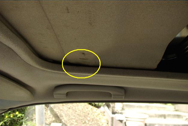

First, you need to push the button to slide the sunroof back. Just enough so that the rear of the sunroof drops about 1/8". At this point, the interior panel can be pushed back into the roof by hand. Once you have done this, try not to slide the roof back any more or you get the situation where the interior panel comes off of its track and no longer slides back when the roof is tilted.

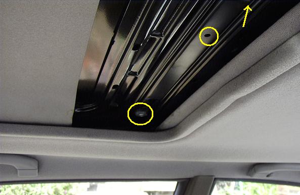

Once you have the interior panel pushed back, move the sunroof (using the switch) back to its normal closed position. Using a 17mm wrench, take off the three large nuts that are in the middle of the roof.

Next, with a torx wrench (T-20, I think) remove the torx screws that are located on the inside of the roof panel, near the front. These are a pain to get back in there once you are all done, you just have to work at it for a bit.
https://www.bmwfans.gr/forum/images/...sunroof5-1.jpg
https://www.bmwfans.gr/forum/images/...sunroof4-1.jpg

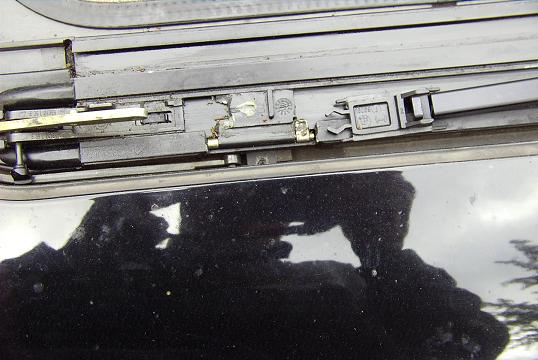

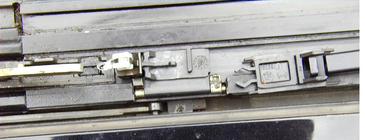

You will now be able to take the roof panel off of the car. Set it in a safe place. You should be able to see where the sunroof lifter block is broken (if it is the lifter, or the lever if it is the lever bracket). It is all one piece, with the base sliding in the track on each edge of the roof opening and the top sliding inside the arm, which is attached to the front sliding base, and to the roof panel beam that spans the width of the roof opening. In the first picture below, the top item circled is the lifter, the bottom one is the lever base.
https://www.bmwfans.gr/forum/images/...sunroof1-1.jpg
https://www.bmwfans.gr/forum/images/...sunroof2-1.jpg

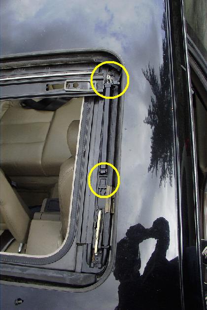

In order to get the lifting blocks out, you need to remove the little blocks near the front of each side that cover the opening to the track. I think those are held in by another T-20 torx screw.

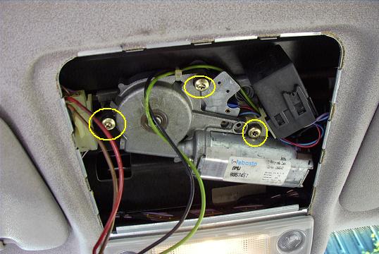

Now, inside the car, remove the panel that contains the sunroof switch, revealing the motor. Remove the three torx screws that hold the motor in and then the motor. This will allow you to slide the sunroof freely.

Remebering the position of the llifting blocks, you can slide the old ones out and slide the new ones in, but be sure to return the lifting blocks to the same location that they were in originally.
https://www.bmwfans.gr/forum/images/...sunroof3-1.jpg

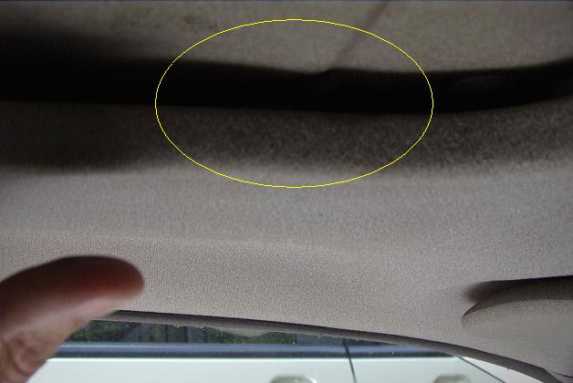

ευχαριστω για την βοηθεια αλλα δεν εχω αυτη την οροφη.ειναι υφασματινη η δικη μου .
συρομενη ανοιγομενη την λεει
https://www.bmwfans.gr/forum/images/...15880b22-1.jpg
Αυτό πρέπει να έχει ο φίλος Βασίλη !
Πολύ ωραία έκδοση αυτή και αρκετα σπάνια.Θα πρέπει να το κοιτάξει κανένας μάστορας που φτιάχνει κουκούλες για κάμπριο αλλιώς δε νομίζω να βγάλεις άκρη.
καλημερα!ειναι απο τα λιγα που κυκλοφορουν στην ελλαδα.κ δεν ξερω τι να κανω.δεν μου τεντωνει το πανει κ μου το αφηνει περιπου 5χιλ ανοιχτο.κ ψαχνω να βρω αν υπαρχει καποιο manual για την οροφη
Εδώ ένα παιδί είχε το ίδιο πρόβλημα και το συνεργείο του απεφάνθη για καινούρια με κόστος 3Κ.
Δεν υπάρχει περίπτωση να μην επισκευάζεται, απλά δεν υπάρχει η εμπειρία πιστεύω.
Εξάλλου υπάρχουν πολλά αμάξια με τέτοια οροφή (Τσικουεντσέντο, ματίζ, C3, κλπ)
