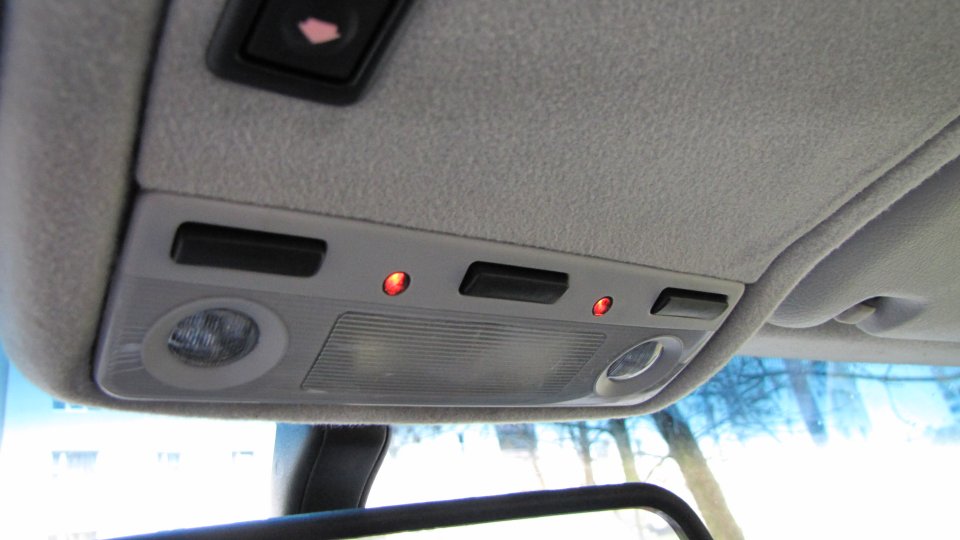

Παράθεση:
Hi...

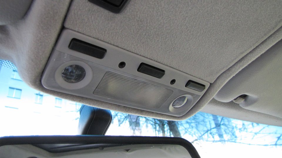

Once IΆve been looking at the web page where MParallel shows his upgraded central dome lighting (E36 conv.) with the diodes from E39....
I decided to do differently.
ThatΆs how IΆve done this.
central lamp from E39

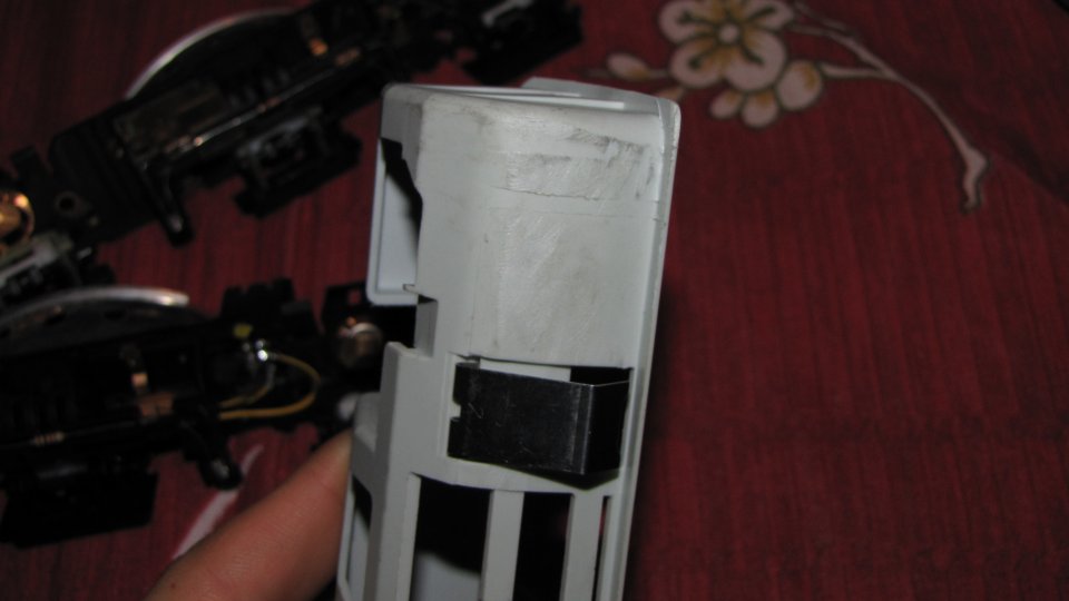

take off front cover
https://s51.radikal.ru/i131/1010/72/7dca4ce3beed.jpg

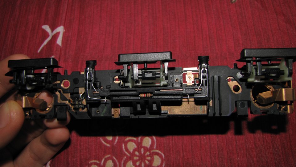

from the back side unclick inside (black) part and push it out
https://s40.radikal.ru/i090/1010/fc/c2a50ad3ccec.jpg
this is that part we gonna work with

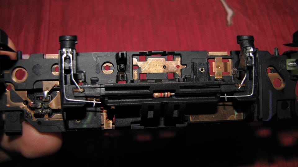

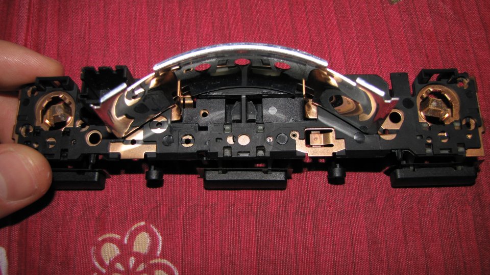

https://www.bmwfans.gr/forum/images/...462b8b6d-1.jpg
https://www.bmwfans.gr/forum/images/...41c5f90c-1.jpg
take off the central switch
https://www.bmwfans.gr/forum/images/...4ef294f9-1.jpg

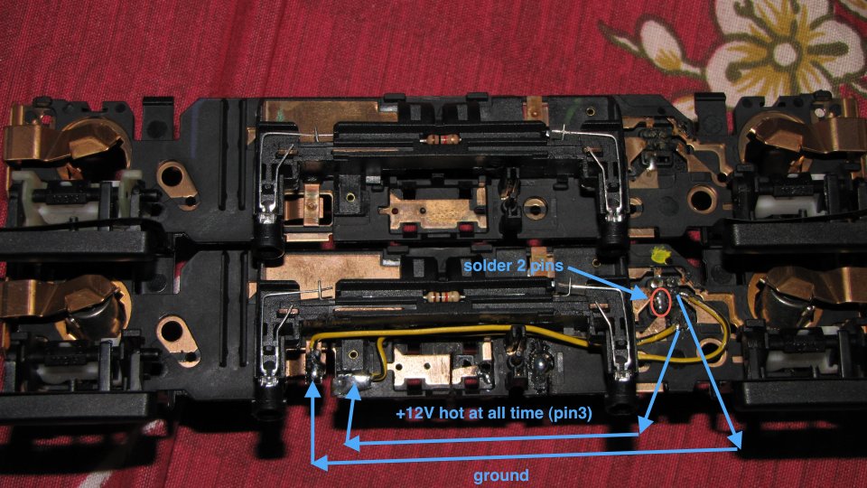

now we need to do some cuts and do some soldering.
before and after photos
https://www.bmwfans.gr/forum/images/...aa1d6ab1-1.jpg
https://s003.radikal.ru/i202/1012/d6/5c627d1670cc.jpg

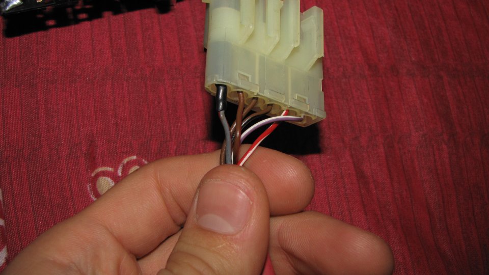

put the wire for power doides into connector (grey-red wire)
https://www.bmwfans.gr/forum/images/...5e77527a-1.jpg
solder together connector from E39 lamp and from your E36 lamp
https://i065.radikal.ru/1010/2a/f9b3e9b89dc0.jpg
now more ditailed what to solder:
1 VIO-WHT to RED-YELL (+12V hot in ACC and start)
2 RED-WHT extand and put it to pin 3 in the lamp(+12V hot at all time)
3 BRN-BLK к RED-BLU (open door signal)
4 BRN to BRN (ground)
5 BRN-RED to BRN-YELL (to make the lamp light when push the central button)
then we put the button on itΆs place and assemble everything else
slightly correct the lamp housing with a file or knife
https://www.bmwfans.gr/forum/images/...ee3a11b6-1.jpg
in the car we need to find only one wire (GRY-RED)
if you have sliding roof, you likely find this wire on the roof switch, you should connect to this wire and put in the central lamp connector in the car
https://www.bmwfans.gr/forum/images/...9f057948-1.jpg
https://www.bmwfans.gr/forum/images/...a6d585a7-1.jpg
https://s61.radikal.ru/i172/1010/ed/f5adb4a5080b.jpg

και ολο αυτο για 2 mood lights??
Που τωρα που το ξανασκεφτομαι αμφιβαλλω αν η γωνια τους ειναι και σωστη....
