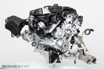

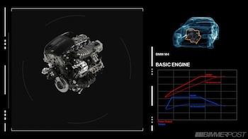

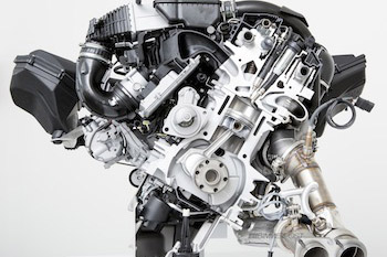

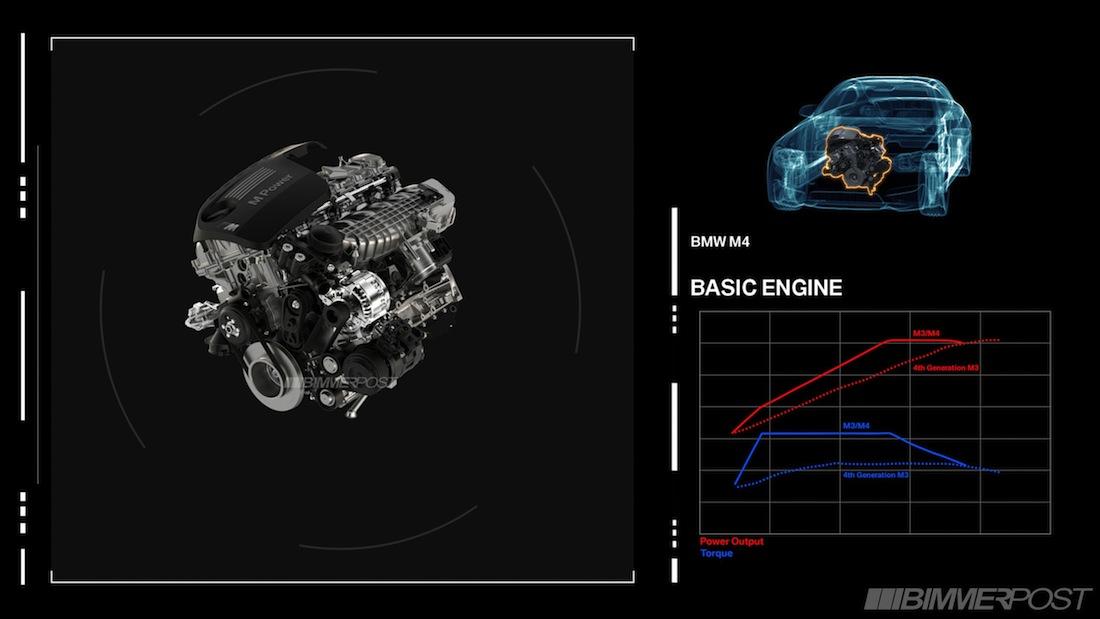

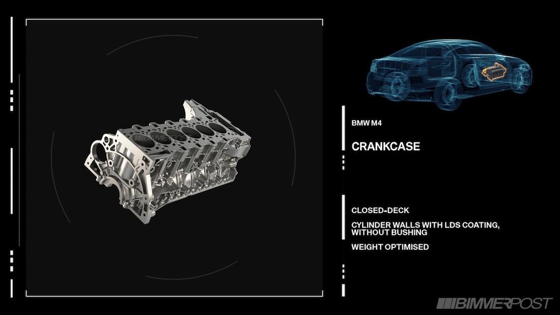

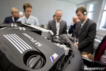

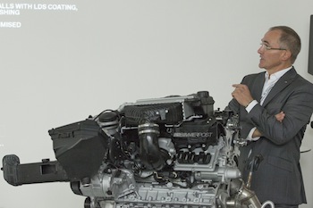

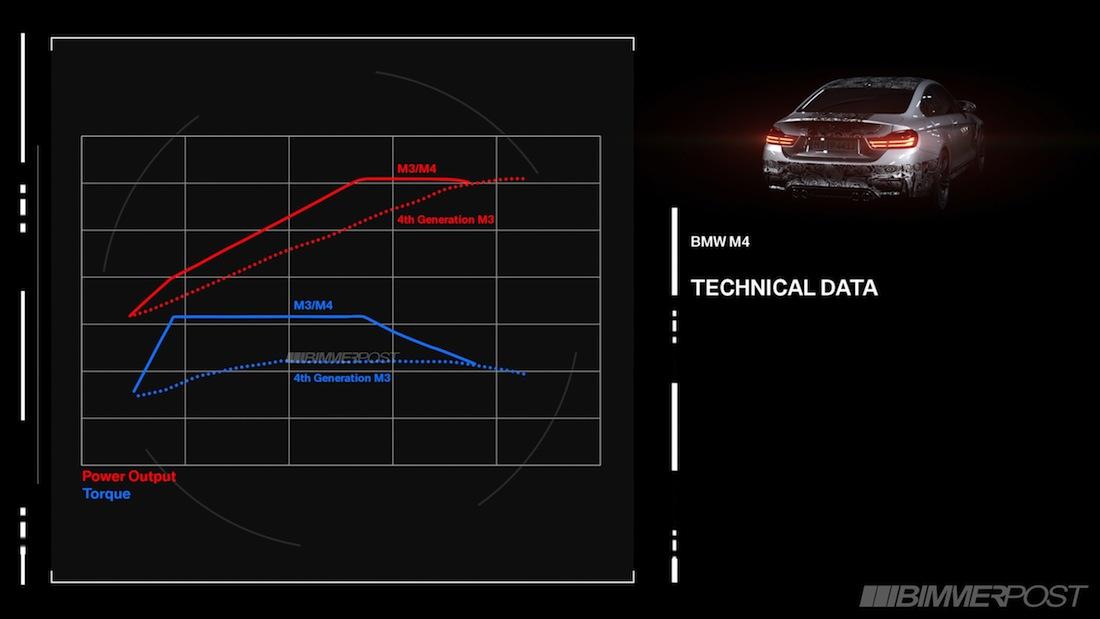

    ENGINE

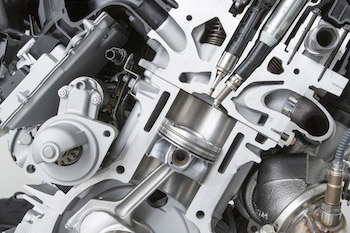

    • Inline 6 cylinder engine with two mono-scroll turbochargers
      • Direct Injection
      • VALVETRONIC
      • Double-VANOS

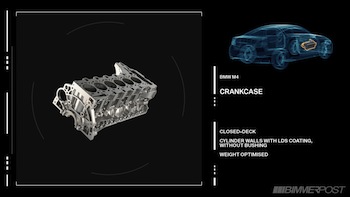

      • closed-decked crankcase
      • twin-wire arc-spray coating (instead of liners) in cylinder bores reduce engine weight
    • 430 HP (approximately)
    • "far beyond" 369+ LB-FT (500 Nm)
    • See Dyno Chart
    • Higher than 7500 RPM redline

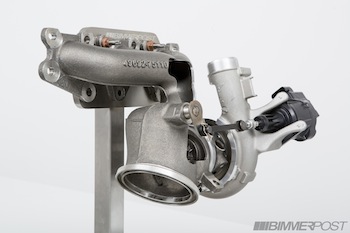

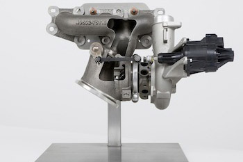

    TURBOS
    • Two mono-scroll turbochargers
    • Impulse charging for optimized responsiveness
    • Flow-enhanced manifolds
    • Electric wastegate actuator

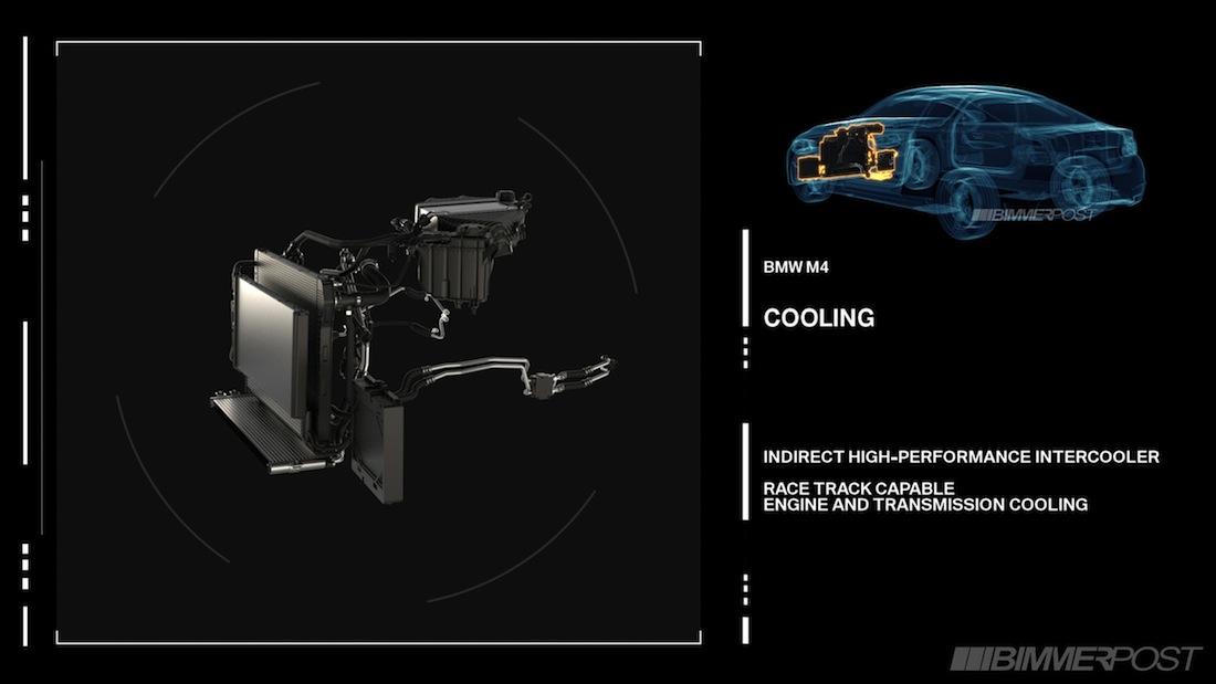

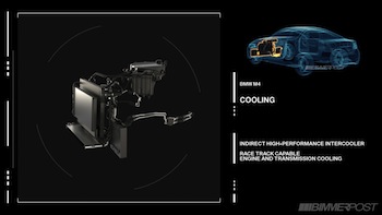

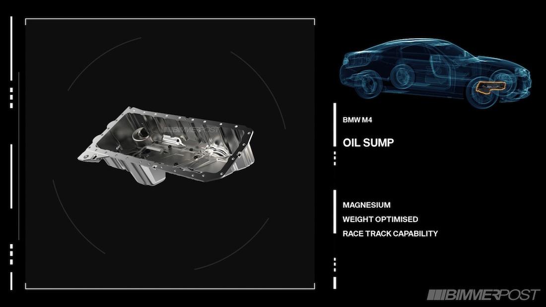

    COOLING

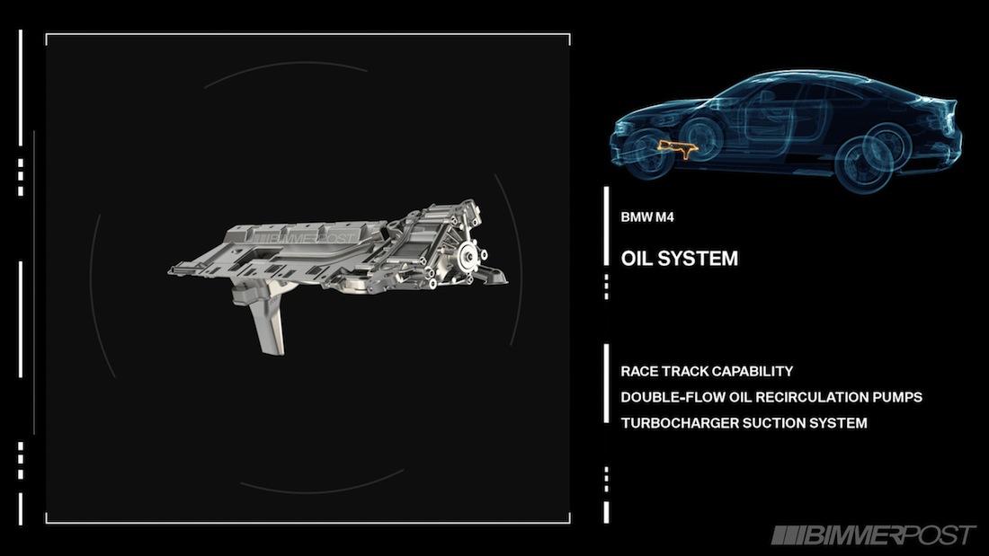

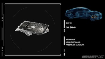

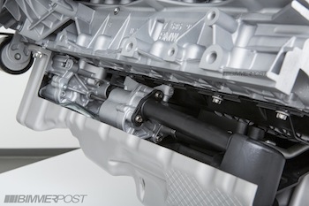

    • Double-flow oil recirculation pumps
    • Turbocharger suction system
    • Main radiator plus additional radiators for the high- and low-temperature circuits, turbocharger and transmission,
    • Large indirect intercooler
    • Low-weight magnesium oil sump
    • Temperature-stabilizing electric water pump
    WEIGHT
    • Under 3,306 lb (1500kg) weight
      • this figure is without driver and with 90% fuel
      • for more clarification, it's mentioned that "the new model is now around 80 kilograms lighter than a comparably equipped predecessor model" [80kg = 176 lbs]
      • compare to E46 M3 at ~3,400 lb curb weight
      • compare to E92 M3 at ~3,600 lb curb weight
      • compare to C63 AMG at ~3,900 lb curb weight
      • compare to RS5 at ~4,000 lb curb weight
    • ~ 7.68 lb/hp power to weight
      • compare to E92 M3 at 8.7
      • compare to C63 AMG at 8.7
      • compare to RS5 at 9.0
      • compare to E46 M3 at 10.25
    • Fuel consumption and emissions reduction of 25%

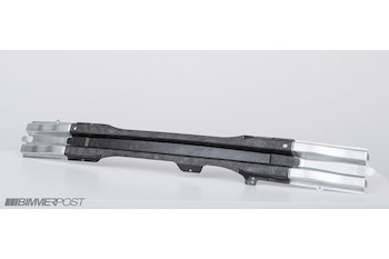

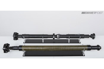

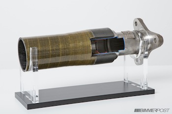

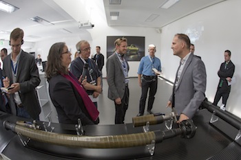

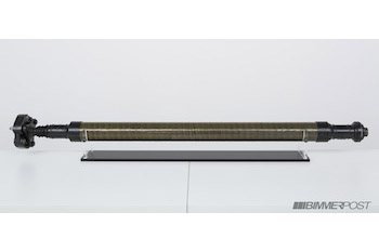

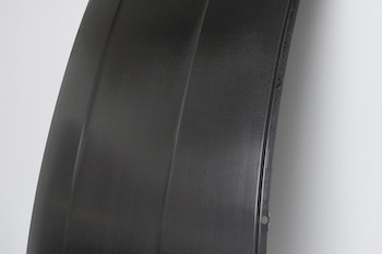

    CARBON FIBER CONSTRUCTION

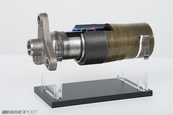

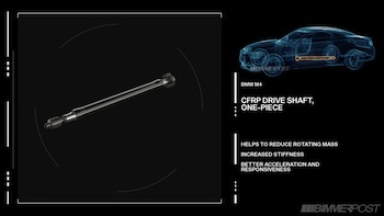

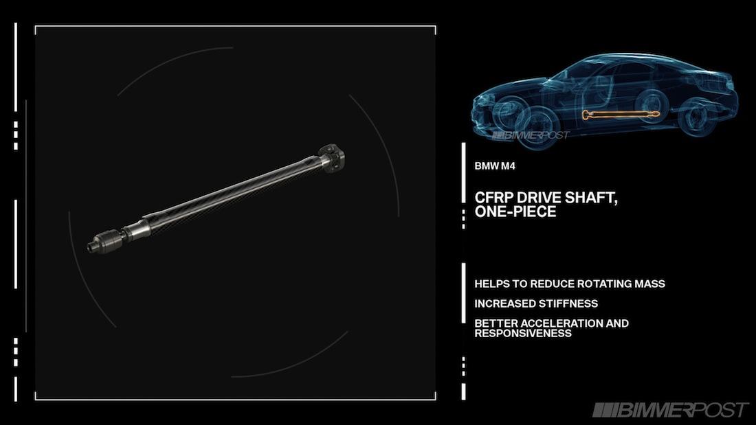

    • CFRP drive shaft
      • 40% weight savings over previous M3
      • increased stiffness
      • reduced rotating mass for better acceleration and throttle response

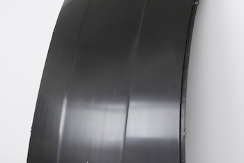

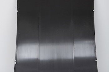

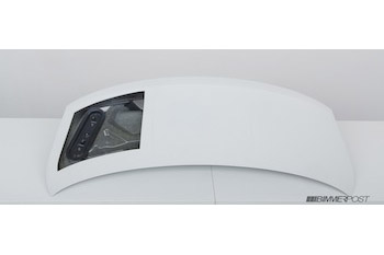

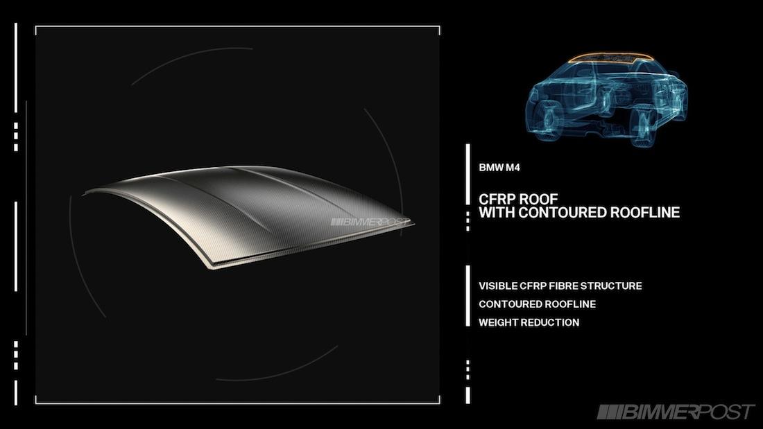

    • CFRP roof for both M3 and M4
      • saves 11 pounds (5kg) on M3
      • saves more than 13.2 pounds (6kg) on M4
    • CFRP roof bow
    • Carbon fiber trunk for M4 (11 pounds (5kg) weight savings)

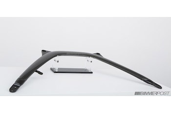

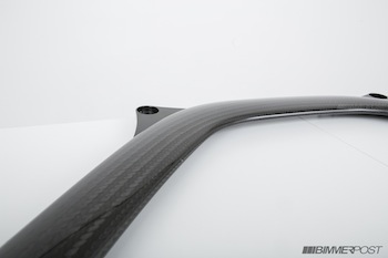

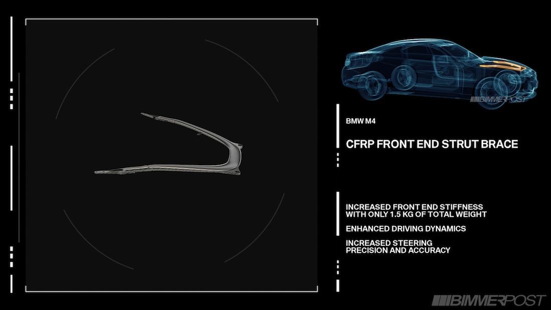

    • CFRP front strut brace standard (weighs just 3.3 pounds (1.5 kg))
    TRANSMISSION
    • Standard 6 speed manual transmission
      • automatic throttle blips on downshift
      • more compact and quieter than predecessor E90/E92 M3 6 speed
      • 26.4 pounds (12kg) lighter
      • carbon fiber friction linings in synchroniser rings
      • dry sump lubrication
    • Optional 7 speed M DCT (double clutch transmission) with launch control
    • Active M Differential (with constantly variable locking a la M5/M6)

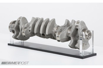

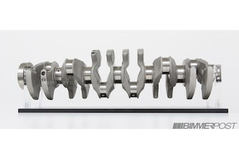

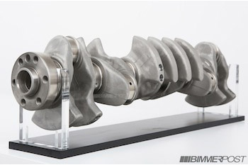

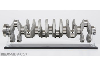

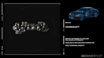

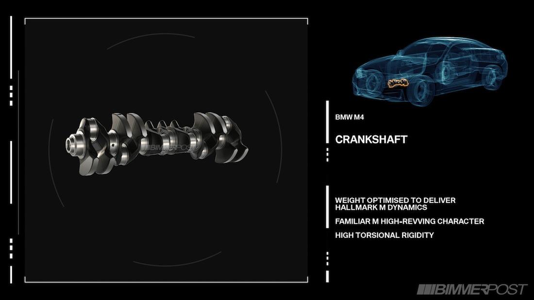

    • Forged crankshaft

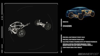

    STEERING
    • Electric power steering specially tuned for M3/M4
    • Servotronic function electronically adjusts the level of steering assistance
    • Three modes: Comfort, Sport, Sport+

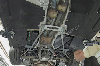

    SUSPENSION / CHASSIS
    • Optional Adaptive M suspension (with Comfort, Sport, Sport+ modes)
    • Double-joint spring strut front axle (saves 11 pounds)
    • New five-link rear axle made from forged aluminum (saves 6.6 pounds)
    • Aluminum suspension
    • Aluminium stiffening plate
    • Rear axle subframe fixed directly to body (bolted joints between the axle subframe and the body sills, without use of elastic rubber elements).
    WHEELS / BRAKES
    • Lightweight forged wheels standard
    • Staggered tire sizes
    • M compound brakes standard (in blue)
    • M carbon ceramic brakes optional (in gold)

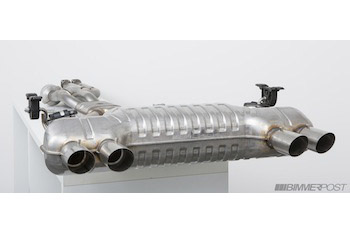

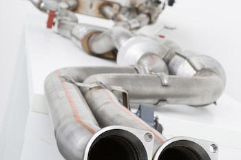

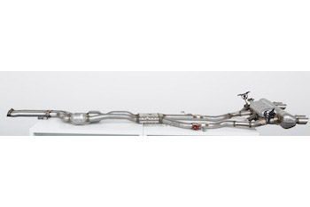

    EXHAUST
    • Exhaust features electrically controlled flaps just before rear silencer to minimize exhaust back-pressure as well as giving precise feedback on engine load.

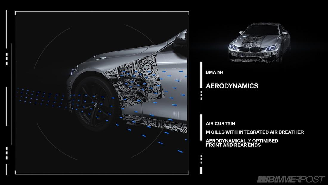

    AERO
    • 50:50 weight distribution

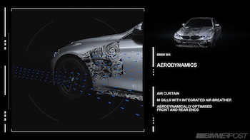

    • Air Curtain
    • M gills with integrated Air Breather behind front wheels
    MISC
    • M3 and M4 to be introduced together (at Detroit NAIAS 2014 in January).
    • M3 and M4 developed with help of BMW race car drivers Bruno Spengler and Timo Glock's participation in extensive testing and set- up runs on the Nürburgring-Nordschleife circuit, focusing on assessment of the carsΆ suspension, tyres and all elements of the powertrain.
    yno / Technical Slides

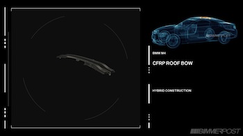

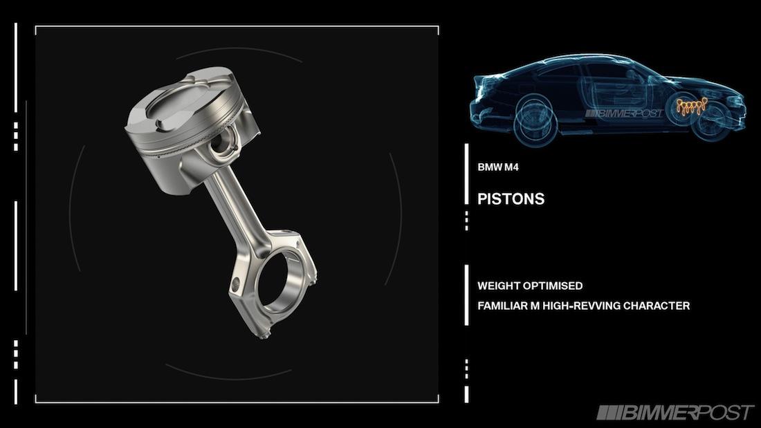

    Highlighted Components

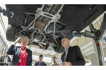

    BMW M3 M4 Workshops in Munich

  16. #10
    16-06-10
    40
    1.967
    5352
    O κεντρικός άξονας πραγματικά πολύ εντυπωσιακός. Μέχρι τώρα, τα Μ είχαν πολύ άκαμπτη (χωρίς ιδιαίτερες αποσβέσεις) μετάδοση προκειμένου να αντέχει στις δυνάμεις που ασκούνται, με αποτέλεσμα η μετάδοση να είναι και θορυβώδης. Λογικά πλέον η θορυβώδης μετάδοση στα Μ είναι παρελθόν, με ακόμη καλύτερη αντοχή...
